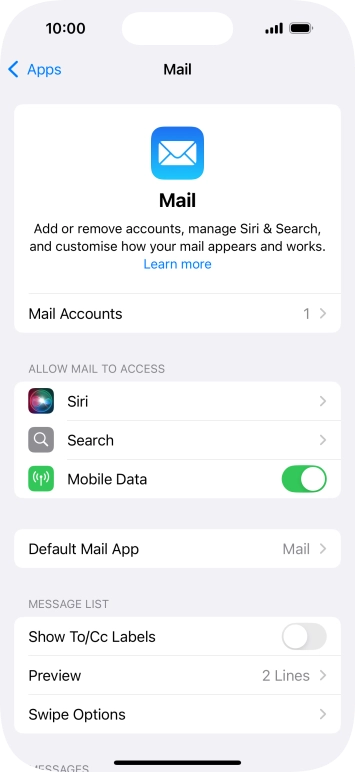

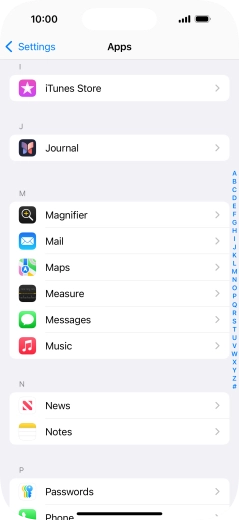

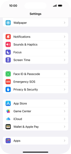

Press Apps.
Press Apps.
Step 2 of 46
Press Apps.
Press Mail.
Press Mail.
Step 3 of 46
Press Mail.
Press Mail Accounts.

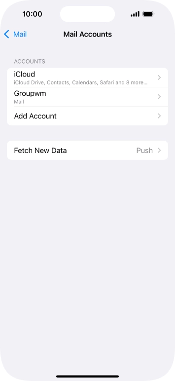

Step 4 of 46

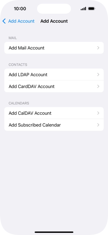

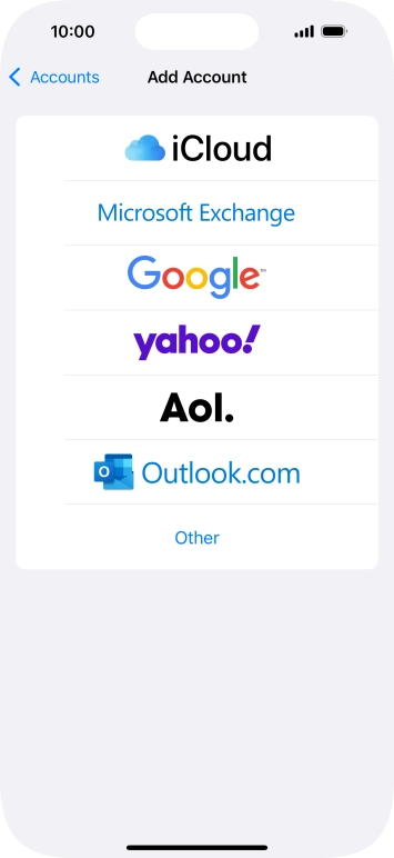

Press Add Account.
Press Add Account.

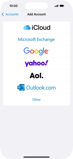

Step 5 of 46
Press Add Account.
Press Other.
Press Other.
Step 6 of 46
Press Other.
If the name of your email provider is on the list, press this instead.
Press Add Mail Account.

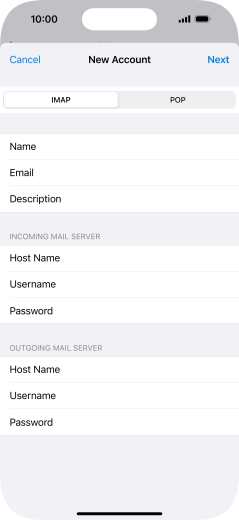

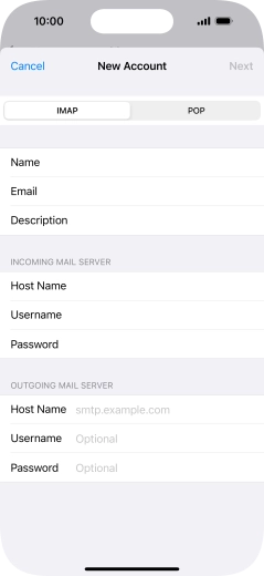

Step 7 of 46

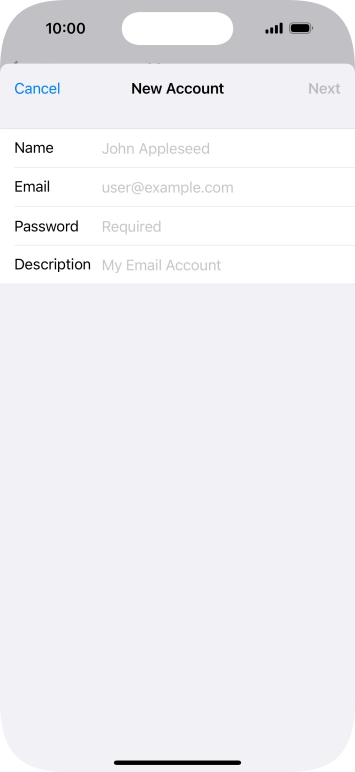

Press Name and key in the required sender name.

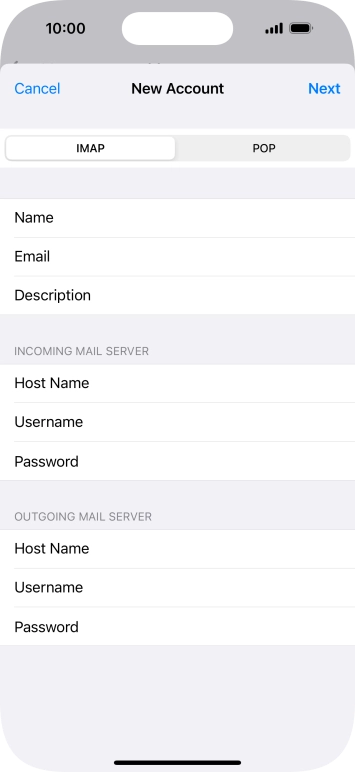

Step 8 of 46
Press Email and key in your email address.
Step 9 of 46
Step 10 of 46
Press Description and key in the required name.
Step 11 of 46
Press Next.
Press Next.
Step 12 of 46
Press Next.
Step 13 of 46

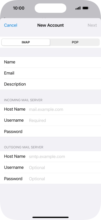

Press IMAP.
Press IMAP.
Step 14 of 46
Press IMAP.
Press Host Name and key in the name of your email provider's incoming server.
Step 15 of 46
Press Username and key in the username for your email account.

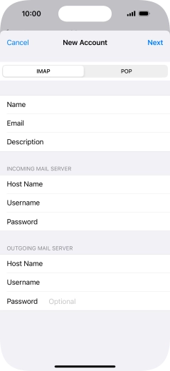

Step 16 of 46
Press Host Name and key in the name of your email provider's outgoing server.
Step 17 of 46
Step 18 of 46

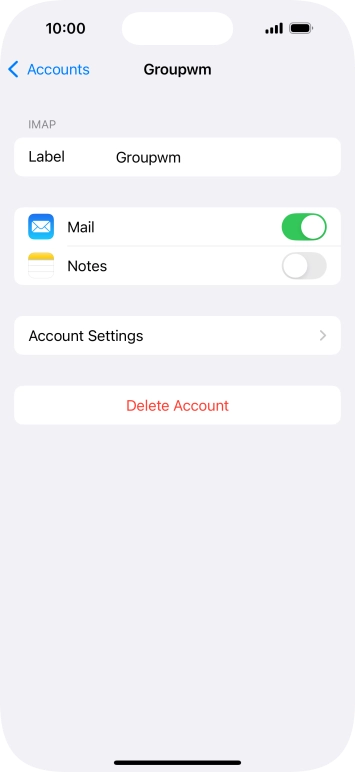

Step 21 of 46
Press Save. Your email account has now been set up. To select more settings for incoming and outgoing server, proceed with the following steps.
Press the name of the email account you've just set up.
Step 22 of 46
Press Account Settings.
Step 23 of 46

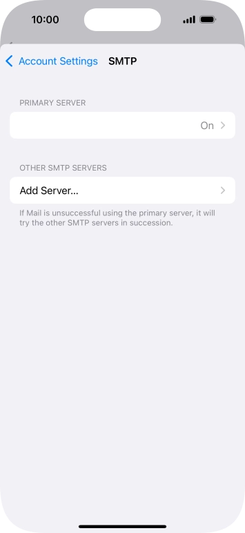

Press SMTP.
Press SMTP.
Step 24 of 46

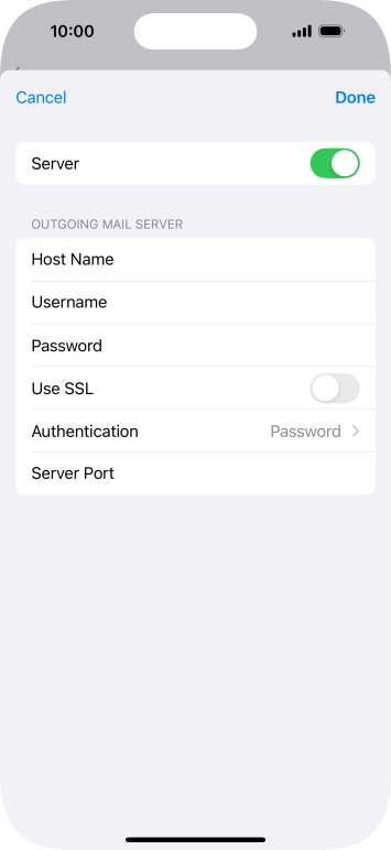

Press SMTP.
Press the field below
Step 25 of 46
Press the field below "PRIMARY SERVER".
Step 26 of 46

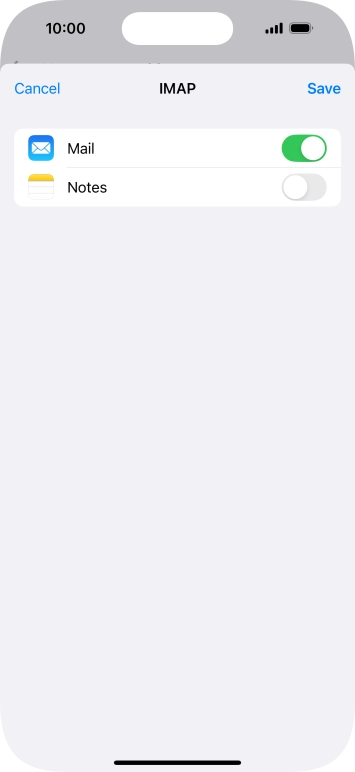

Press the indicator next to "Use SSL" to turn on the function.
It's recommended that you turn on encryption of outgoing email messages so that all email messages you send are encrypted and secured in the best possible way.

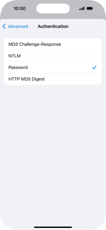

Press Authentication.
Step 27 of 46
Press Password.
Press Password.
Step 28 of 46
Press Password.
Press arrow left.
Press arrow left.
Step 29 of 46
Press arrow left.
Press Server Port and key in 587.
587
587
Step 30 of 46
If you're having problems sending email messages, try keying in 465 instead or ask your email provider for the correct outgoing port.

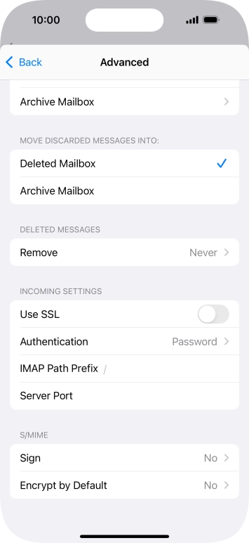

Press Advanced.
Press Advanced.
Step 33 of 46
Press Advanced.
Step 34 of 46
It's recommended that you turn on encryption of incoming email messages so that all email messages you receive are encrypted and secured in the best possible way.

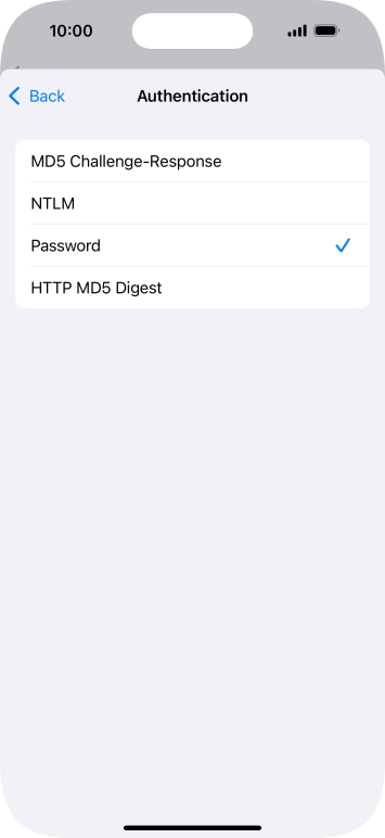

Step 35 of 46
Press Password.
Press Password.

Step 41 of 46
Press arrow left.
Press Fetch New Data.
Step 42 of 46

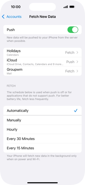

Step 43 of 46

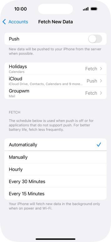

Press the indicator next to "Push" to turn the function on or off.
If you turn off the function, press the required setting.
Step 44 of 46
Press the required email account and follow the instructions on the screen to select settings for the specific account.
