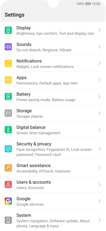

Step 1 of 41

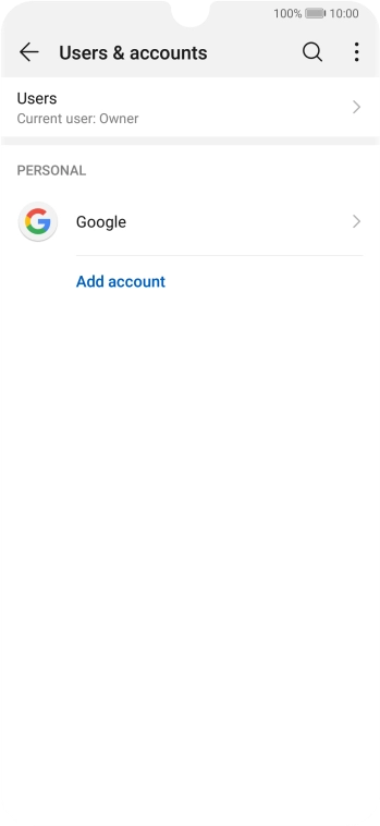

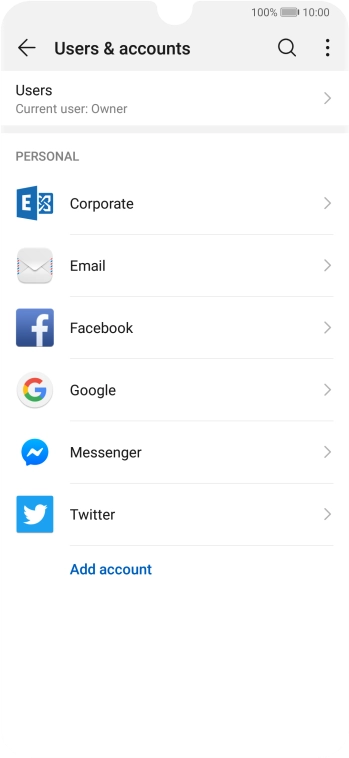

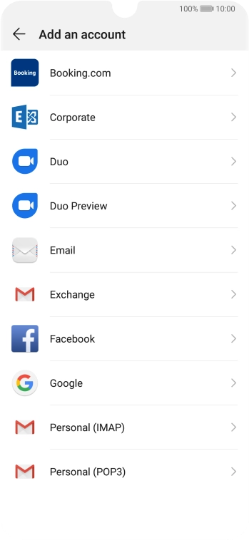

Press Users & accounts.
Step 2 of 41
Press Add account.
Press Add account.
Step 3 of 41
Press Add account.
Press Email.
Press Email.

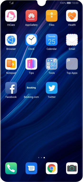

Step 4 of 41
Press Email.

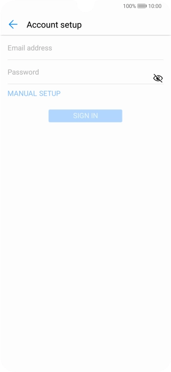

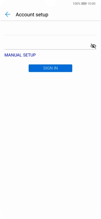

Press Email address and key in your email address.
Step 5 of 41

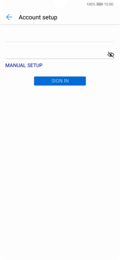

Step 6 of 41
Press SIGN IN.
Press SIGN IN.
Step 7 of 41
Press SIGN IN.

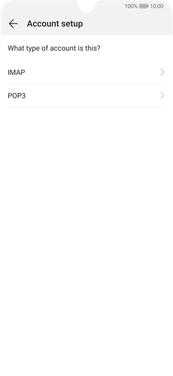

Step 8 of 41
Press POP3.
Press POP3.
Step 9 of 41
Press POP3.

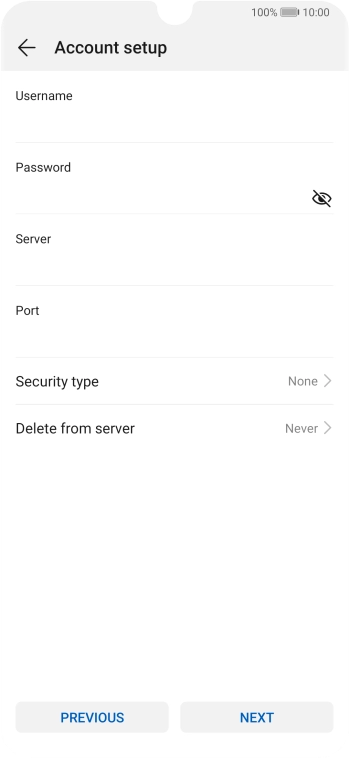

Press the field below
Step 10 of 41
Step 11 of 41
110
110
Step 12 of 41
Press the field below "Port" and key in 110.

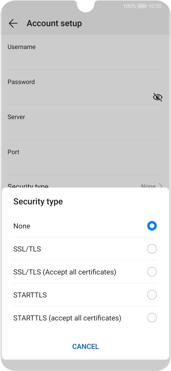

Press Security type.
Step 13 of 41
Press None to turn off the function.
Step 14 of 41

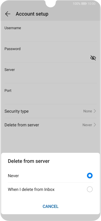

Press Delete email from server.
Step 15 of 41
Press Never to keep email on the server when you delete them on your phone.
Step 16 of 41
Press When I delete from Inbox to delete email on the server when you delete them on your phone.
Step 17 of 41
Press NEXT.
Press NEXT.

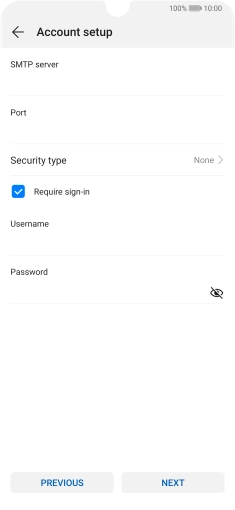

Press NEXT.
Step 19 of 41
25
25
Step 20 of 41

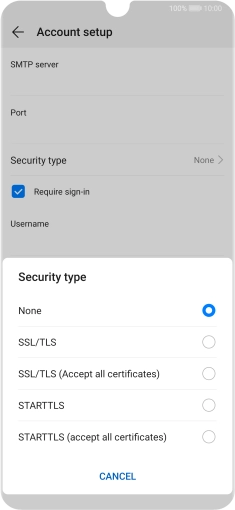

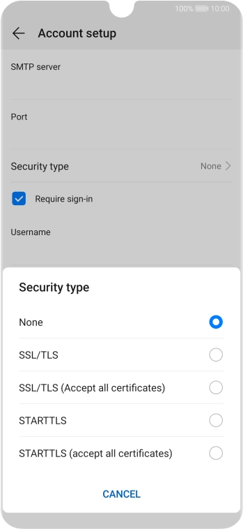

Step 21 of 41
Step 22 of 41

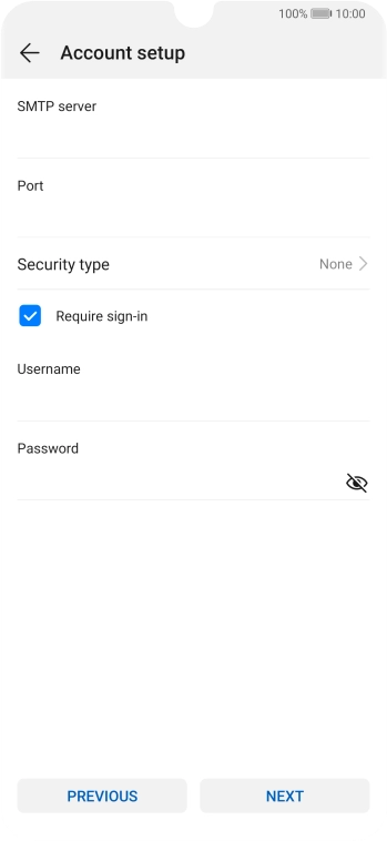

Press the field next to
Step 23 of 41
Press the field next to "Require sign-in" to turn on the function.
Step 24 of 41
Step 25 of 41
Press NEXT.
Press NEXT.

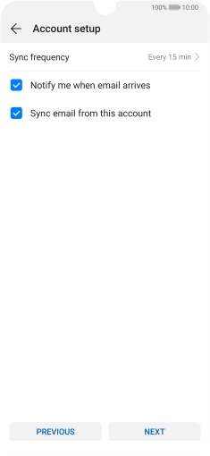

Step 26 of 41
Press NEXT.

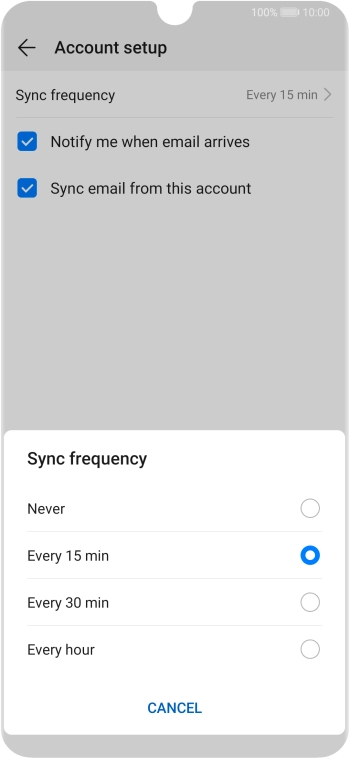

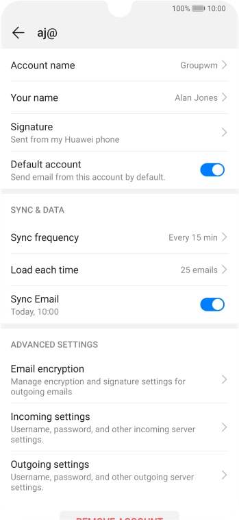

Press Sync frequency.
Step 27 of 41
Press the required setting.
Step 28 of 41

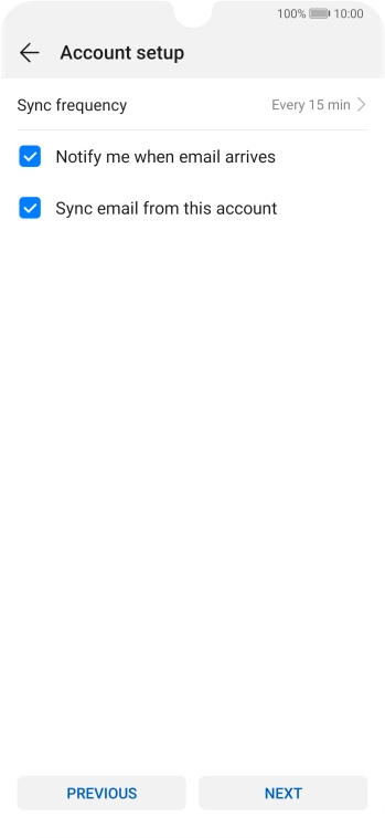

Step 29 of 41
Press the field next to "Notify me when email arrives" to turn the function on or off.
Step 30 of 41
Press the field next to "Sync email from this account" to turn on the function.
Press NEXT.
Press NEXT.

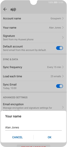

Step 36 of 41

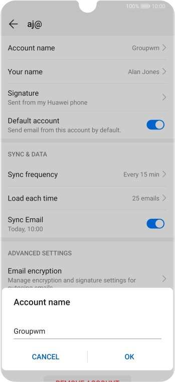

Press Account name and key in the required name.
Step 37 of 41
Press OK.
Press OK.
