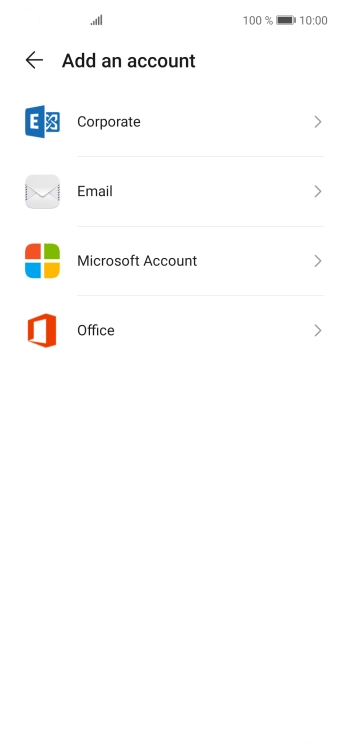

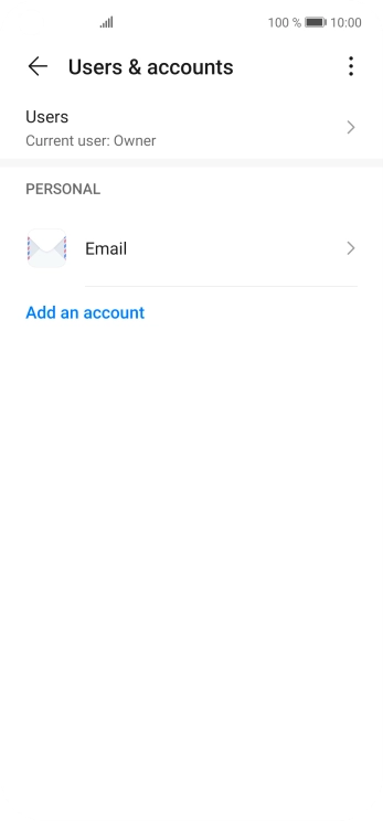

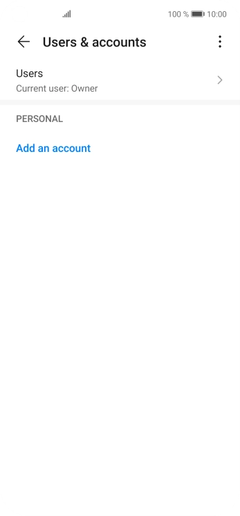

Press Users & accounts.
Step 2 of 39
Press Add an account.
Step 3 of 39
Press Email.
Press Email.

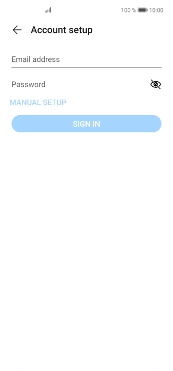

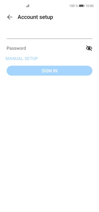

Step 6 of 39
Press SIGN IN.
Press SIGN IN.
Step 7 of 39
Press SIGN IN.

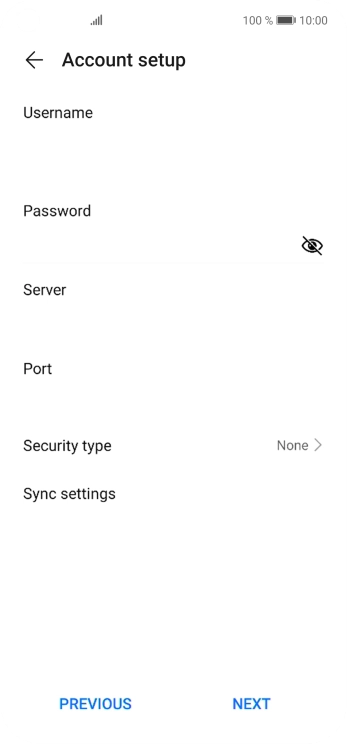

Step 8 of 39

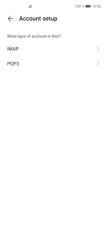

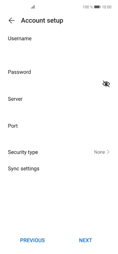

Press POP3.
Press POP3.

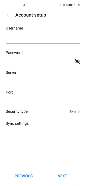

Step 9 of 39
Press POP3.

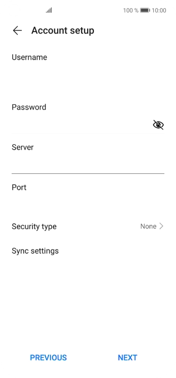

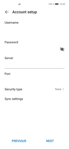

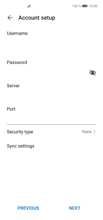

Press the field below
Step 10 of 39

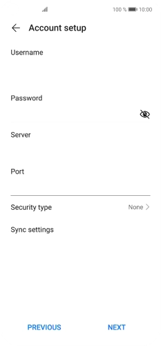

Step 11 of 39
110
110
Step 12 of 39
Press the field below "Port" and key in 110.

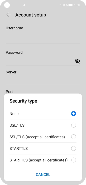

Press Security type.
Step 13 of 39
Press None.
Press None.
Step 14 of 39
Press None.
Press Sync settings and follow the instructions on the screen to turn deletion of email messages on the server on or off.
Step 15 of 39
Press NEXT.
Press NEXT.
Step 16 of 39

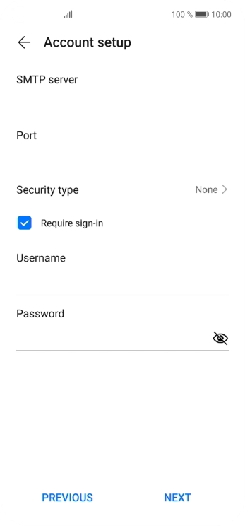

Press NEXT.
Step 17 of 39
25
25

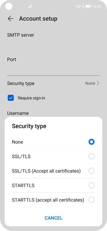

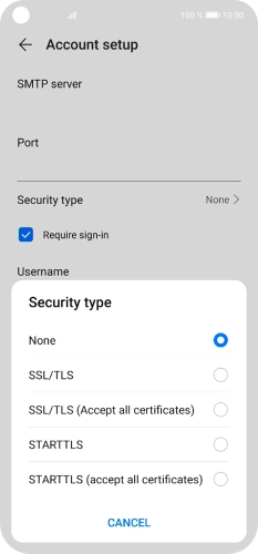

Step 18 of 39
Step 19 of 39
Press None.
Press None.
Step 20 of 39
Press None.
Press the field next to
Step 21 of 39
Press the field next to "Require sign-in" to turn on the function.
Step 22 of 39
Step 23 of 39
Press NEXT.
Press NEXT.

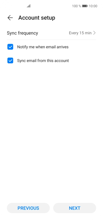

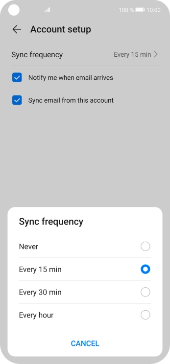

Step 24 of 39
Press NEXT.
Press Sync frequency.
Step 25 of 39
Press the required setting.
Step 26 of 39
Step 27 of 39
Press the field next to "Notify me when email arrives" to turn the function on or off.
Step 28 of 39
Press the field next to "Sync email from this account" to turn on the function.
Press NEXT.
Press NEXT.

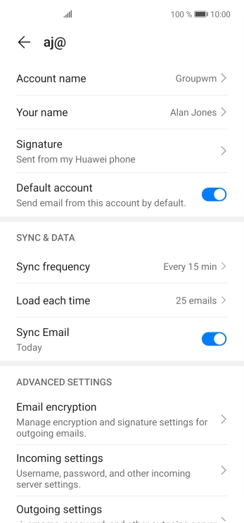

Step 29 of 39
Press NEXT.
Step 30 of 39
Press Email.
Press Email.
Step 31 of 39
Press Email.
Step 32 of 39

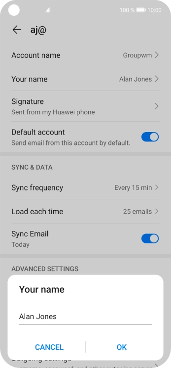

Step 33 of 39
Step 34 of 39
Press Account name and key in the required name.
Step 35 of 39
Press OK.
Press OK.
Step 36 of 39
Press OK.
Step 37 of 39
Press OK.
Press OK.
Step 38 of 39
Press OK.
Step 39 of 39
