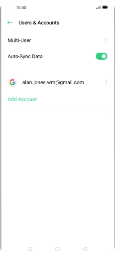

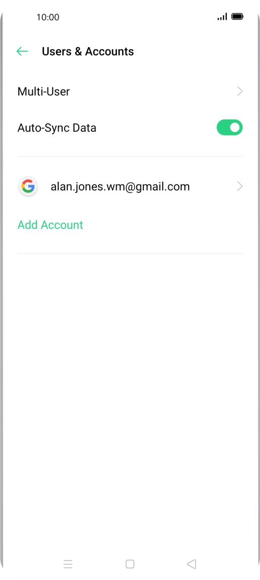

Press Users & Accounts.
Step 3 of 36
Press Add Account.
Press Add Account.
Step 4 of 36
Press Add Account.

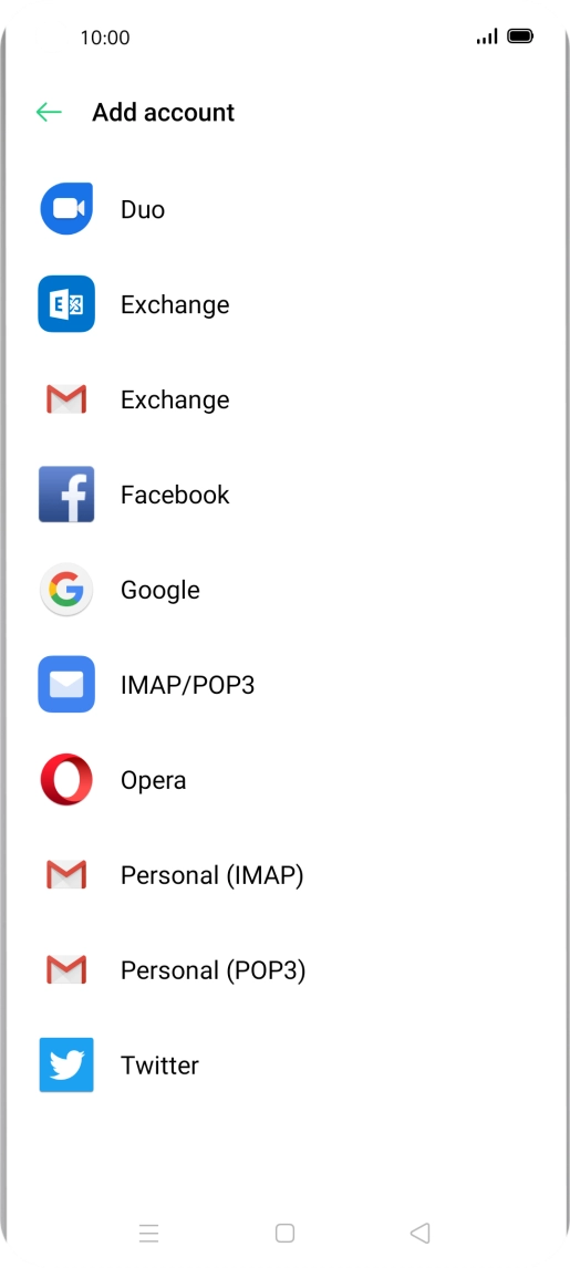

Press IMAP/POP3.
Press IMAP/POP3.
Step 5 of 36
Press IMAP/POP3.

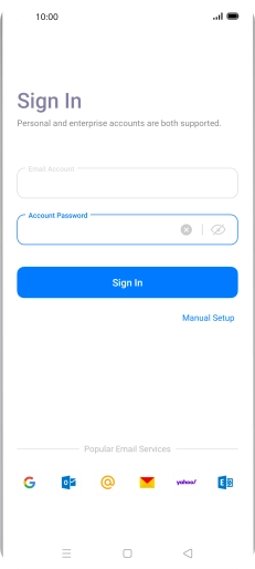

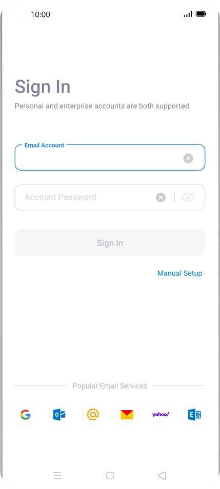

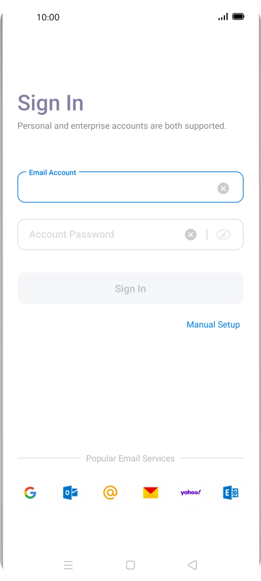

Press the field below
Step 6 of 36
Press the field below "Email Account" and key in your email address.

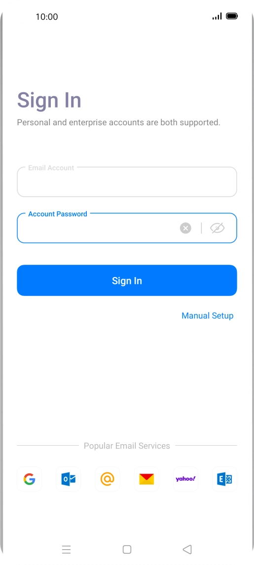

Press Account Password and key in the password for your email account.
Step 7 of 36
Press Sign In.
Press Sign In.
Step 8 of 36
Press Sign In.

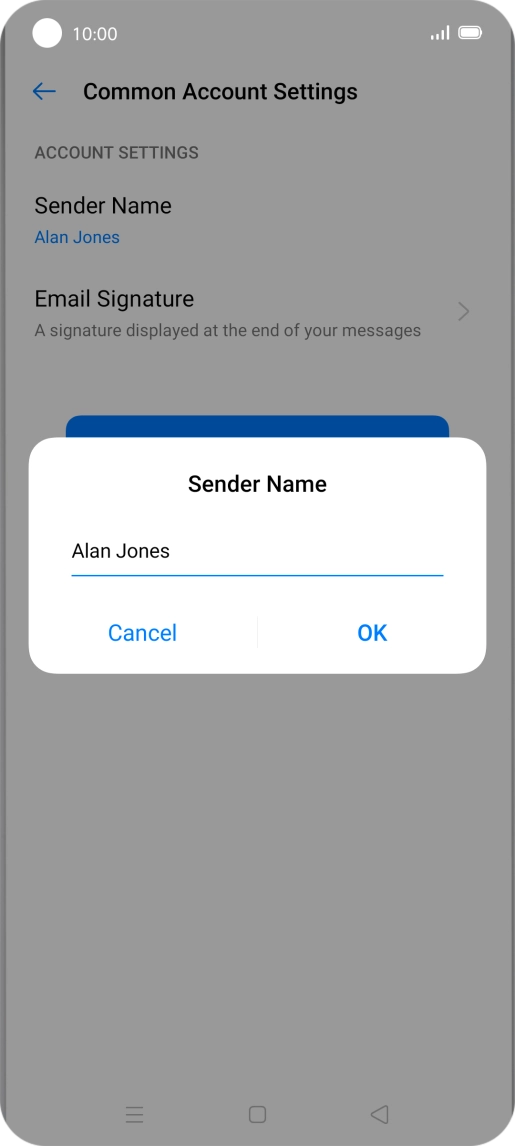

Press Sender Name and key in the required sender name.
Step 9 of 36
Press OK.
Press OK.

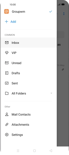

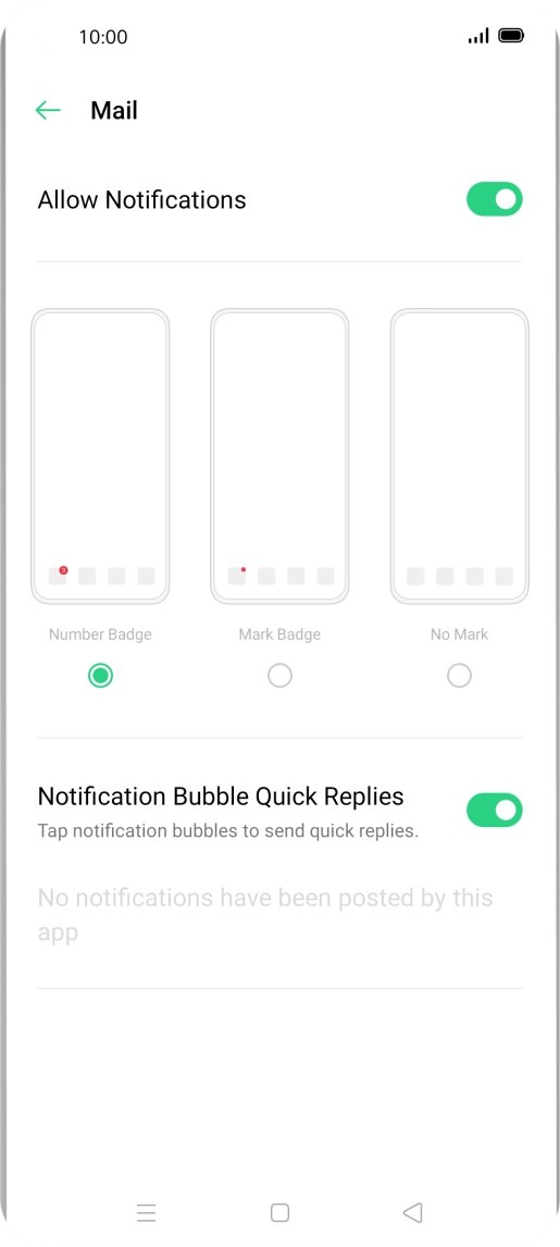

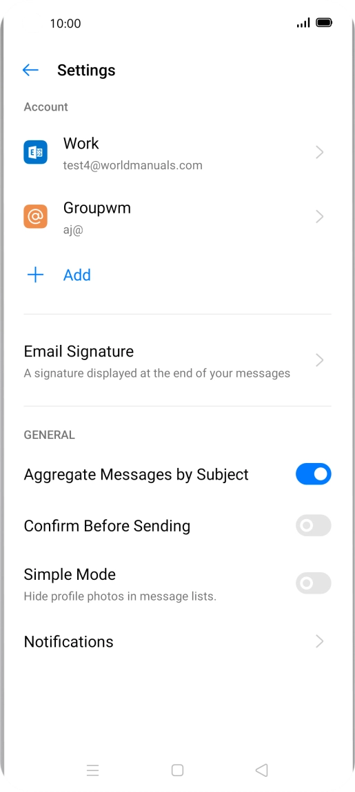

Press Notifications.
Step 14 of 36
Step 15 of 36
Press the indicator next to "Allow Notifications" to turn the function on or off.
Press the Return key.
Step 16 of 36

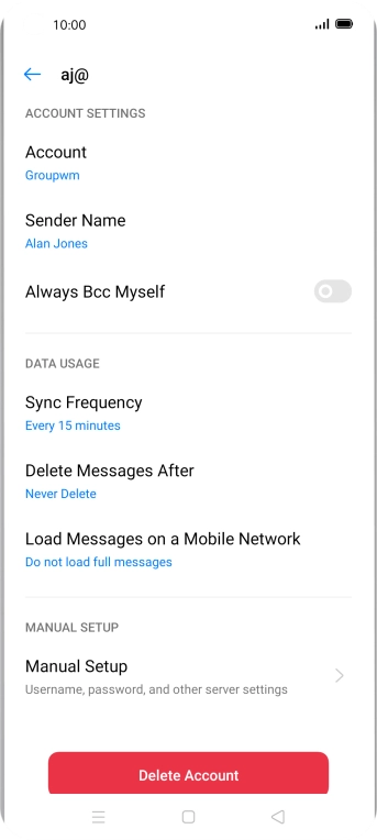

Press Account and key in the required name.
Step 18 of 36
Press OK.
Press OK.
Step 19 of 36
Press OK.

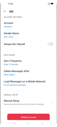

Press Sync Frequency.
Step 20 of 36
Press the required setting.
Step 21 of 36
Press Manual Setup.
Press Manual Setup.

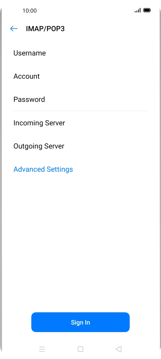

Press Username and key in the username for your email account.
Step 24 of 36

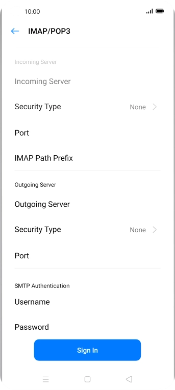

Press Incoming Server and key in the name of your email provider's incoming server.

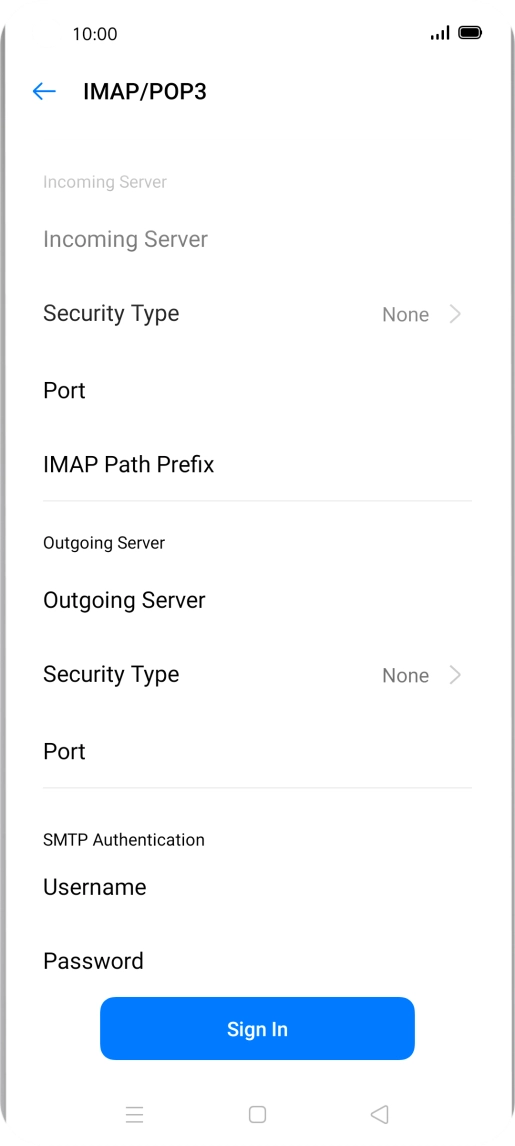

Step 25 of 36
Press Security Type.
Step 26 of 36
Press None.
Press None.
Step 27 of 36
Press None.
Press Port and key in 110.
110
110
Step 28 of 36
Press Outgoing Server and key in the name of your email provider's outgoing server.
Step 29 of 36
Step 30 of 36
Press None.
Press None.
Step 31 of 36
Press None.
Press Port and key in 25.
25
25
Step 32 of 36
Press Username and key in the username of your email provider's outgoing server.
Step 33 of 36
Press Password and key in the password for your email provider's outgoing server.
Step 34 of 36
Press Sign In.
Press Sign In.
Step 35 of 36
Press Sign In.
Step 36 of 36
