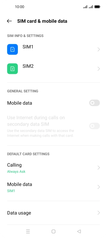

Step 3 of 19
Press SIM card & mobile data.
Press the required SIM.

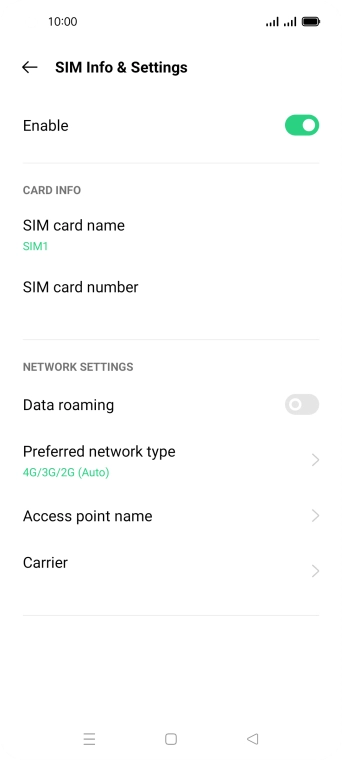

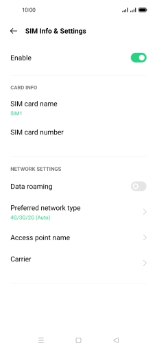

Step 4 of 19

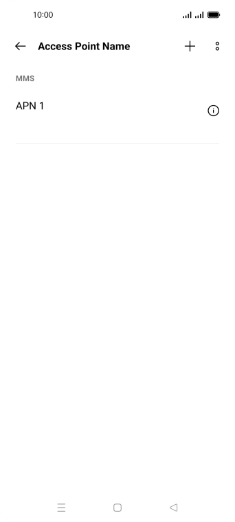

Press Access point name.

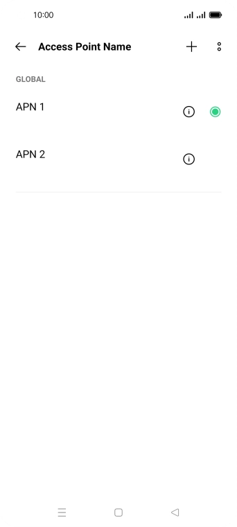

Step 5 of 19
Press the add icon.
Press the add icon.

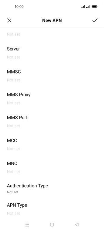

Step 6 of 19
Press the add icon.

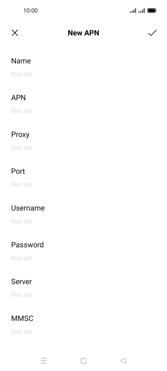

Press the field below
EE MMS
EE MMS
Step 7 of 19
Press the field below "Name" and key in EE MMS.
eezone
eezone
Step 8 of 19
Press the field below "APN" and key in eezone.
eesecure
eesecure
Step 9 of 19
Press the field below "Username" and key in eesecure.
secure
secure
Step 10 of 19
Press the field below "Password" and key in secure.

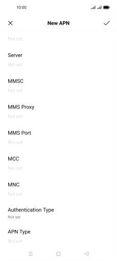

149.254.201.135
149.254.201.135
Step 11 of 19
Press the field below "MMS Proxy" and key in 149.254.201.135.
8080
8080
Step 12 of 19
Press the field below "MMS Port" and key in 8080.
234
234
Step 13 of 19
Press the field below "MCC" and key in 234.
33
33
Step 14 of 19
Press the field below "MNC" and key in 33.
Press Authentication Type.

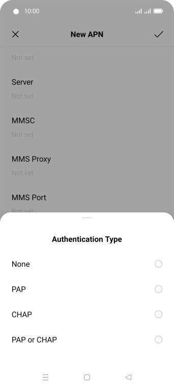

Step 15 of 19
Press PAP.
Press PAP.
Step 16 of 19
Press PAP.
mms
mms
Step 17 of 19
Press the field below "APN Type" and key in mms.
Press the confirm icon.
Step 18 of 19
