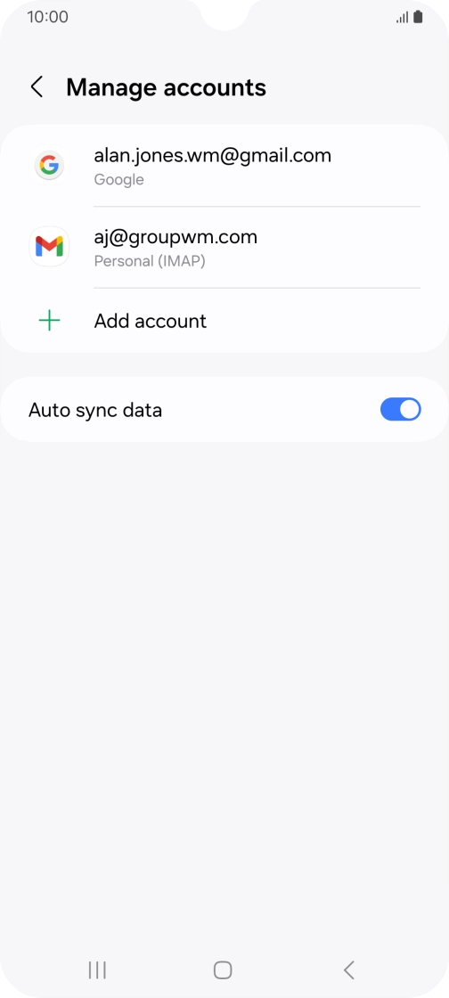

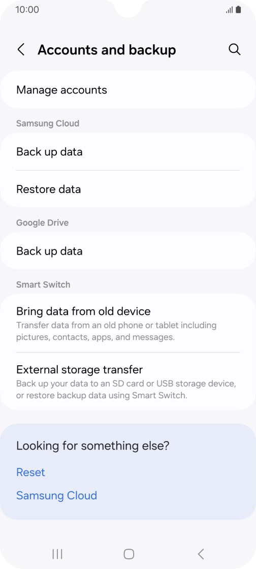

Press Accounts and backup.
Step 3 of 34

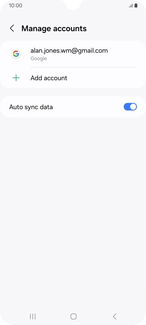

Press Manage accounts.

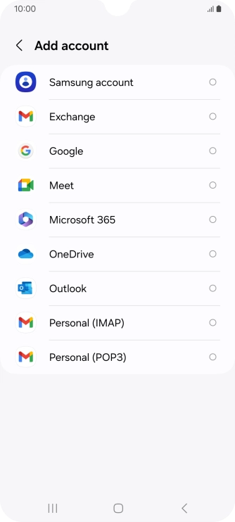

Step 4 of 34
Press Add account.
Press Add account.

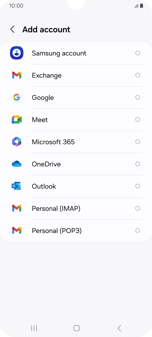

Step 5 of 34
Press Add account.

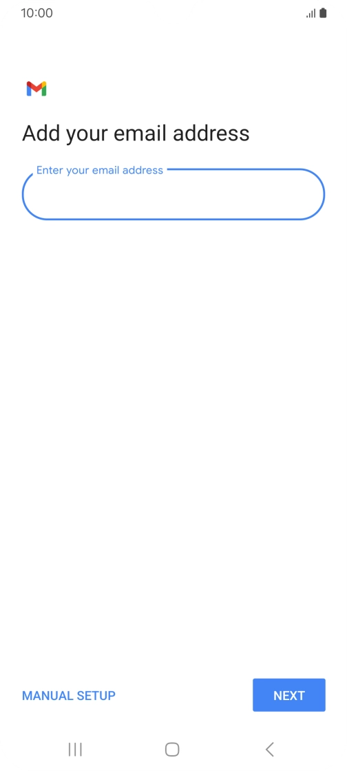

Press Personal (IMAP).

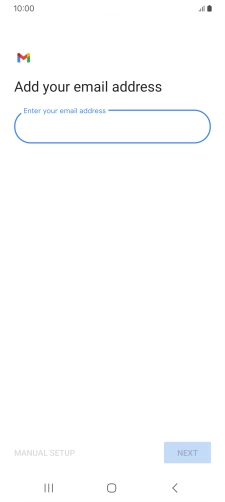

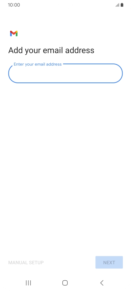

Step 6 of 34
Press the field below
Step 7 of 34
Press NEXT.
Press NEXT.

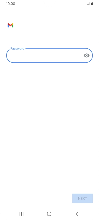

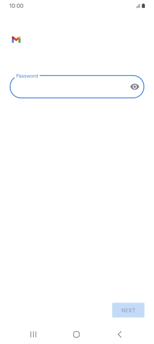

Step 8 of 34
Press NEXT.

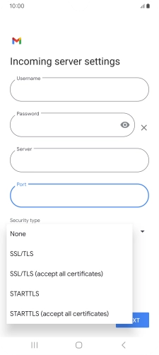

Step 13 of 34

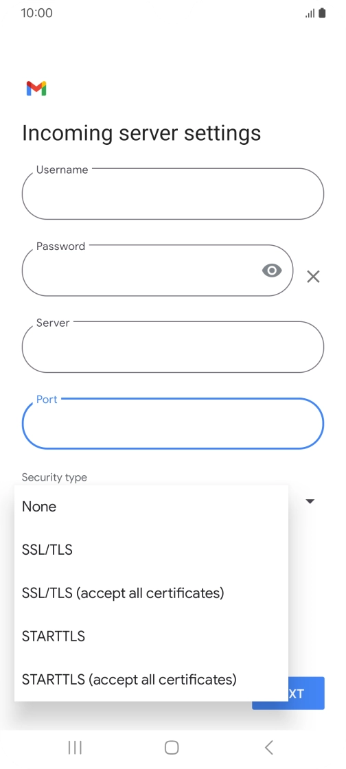

993
993
Step 14 of 34
Press the field below "Port" and key in 993.
Step 15 of 34

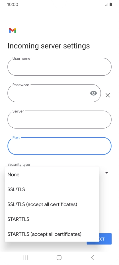

Press SSL/TLS.
Press SSL/TLS.

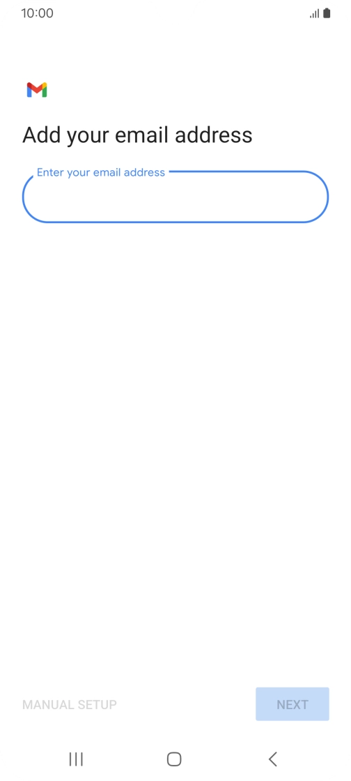

Step 16 of 34
Press SSL/TLS.
It's recommended that you turn on encryption of incoming email messages so that all email messages you receive are encrypted and secured in the best possible way.
Press NEXT.
Press NEXT.

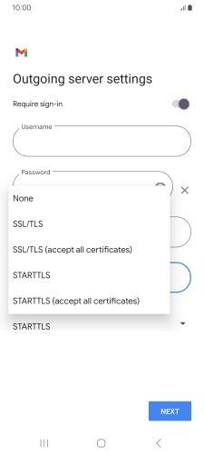

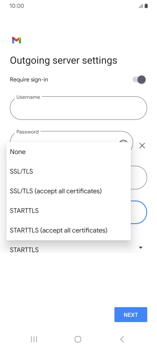

Step 23 of 34
Press SSL/TLS.
Press SSL/TLS.
Step 24 of 34
Press SSL/TLS.
It's recommended that you turn on encryption of outgoing email messages so that all email messages you send are encrypted and secured in the best possible way.
Press NEXT.
Press NEXT.

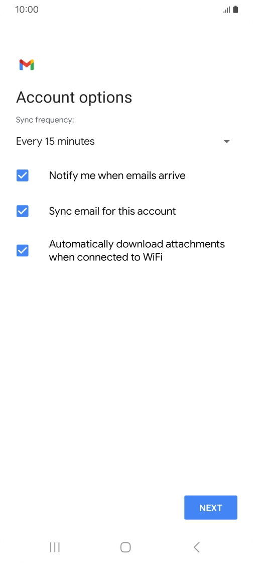

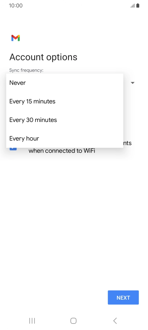

Step 26 of 34
Press the required setting.
Step 27 of 34
Press the field next to
Step 28 of 34

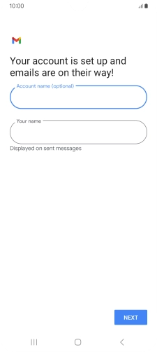

Step 31 of 34

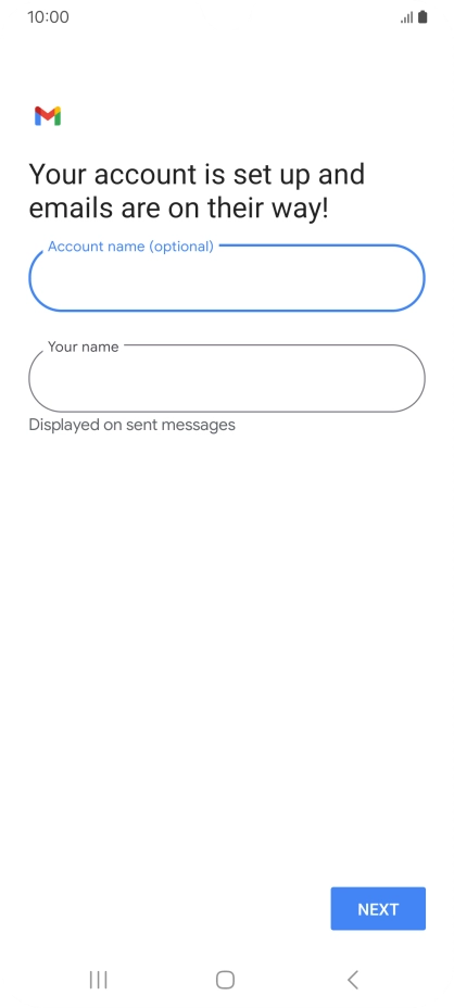

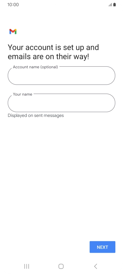

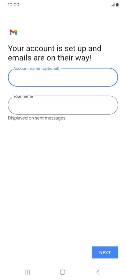

Step 32 of 34
Press the field below "Your name" and key in the required sender name.
Press NEXT.
Press NEXT.
Step 33 of 34
Press NEXT.
Step 34 of 34
