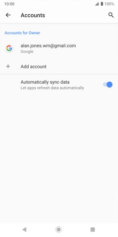

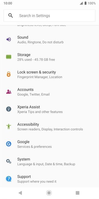

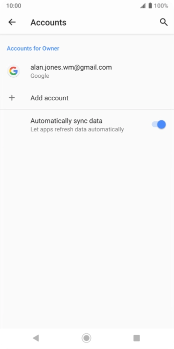

Press Accounts.
Press Accounts.
Step 3 of 40
Press Accounts.

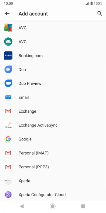

Press Add account.
Press Add account.
Step 4 of 40
Press Add account.
Press Email.
Press Email.

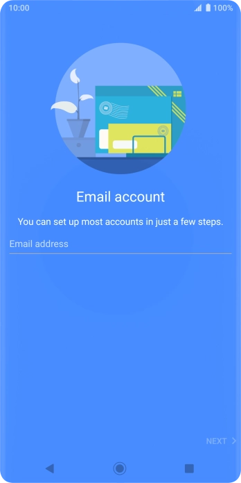

Press Email address and key in your email address.

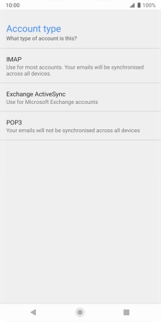

Step 10 of 40
Press POP3.
Press POP3.

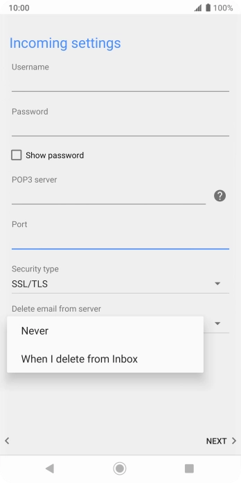

Step 11 of 40
Press POP3.
Press the field below
Step 12 of 40
Step 13 of 40
Press the field below "POP3 server" and key in the name of your email provider's incoming server.
110
110
Step 14 of 40
Press the field below "Port" and key in 110.

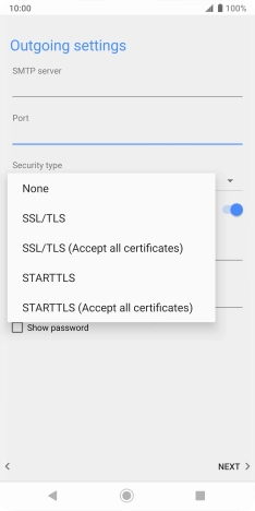

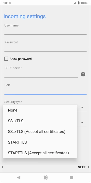

Step 15 of 40
Press None to turn off the function.
Step 16 of 40
Step 17 of 40
Press the drop down list below "Delete email from server".
Press Never to keep email messages on the server when you delete them on your phone.
Step 18 of 40
Press When I delete from Inbox to delete email messages on the server when you delete them on your phone.

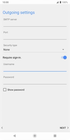

Step 21 of 40
25
25

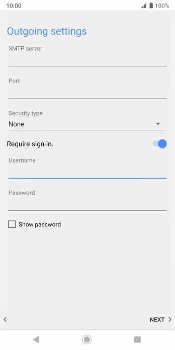

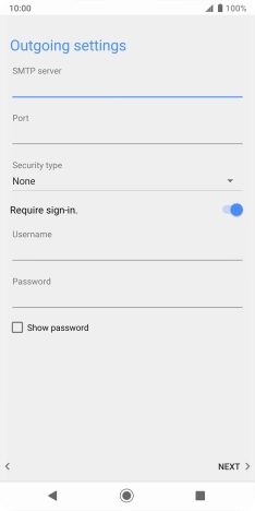

Step 23 of 40
Step 24 of 40

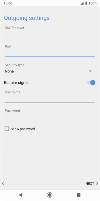

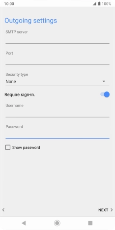

Step 25 of 40
Press the indicator next to "Require sign-in." to turn on the function.
Step 26 of 40

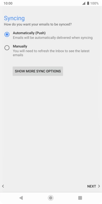

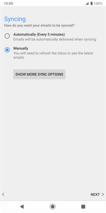

Press SHOW MORE SYNC OPTIONS.
Step 29 of 40

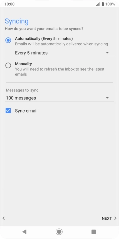

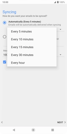

Step 30 of 40

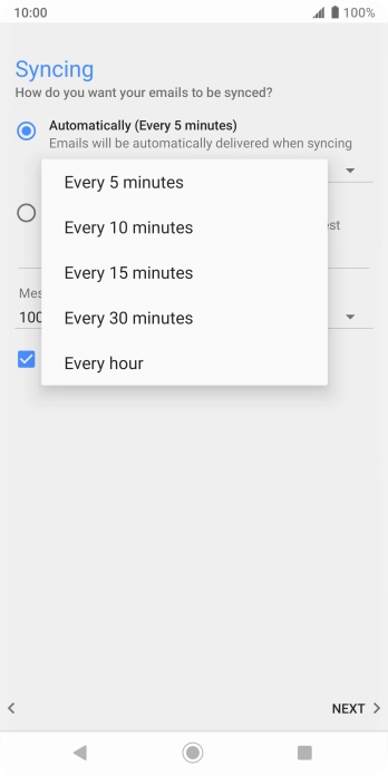

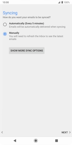

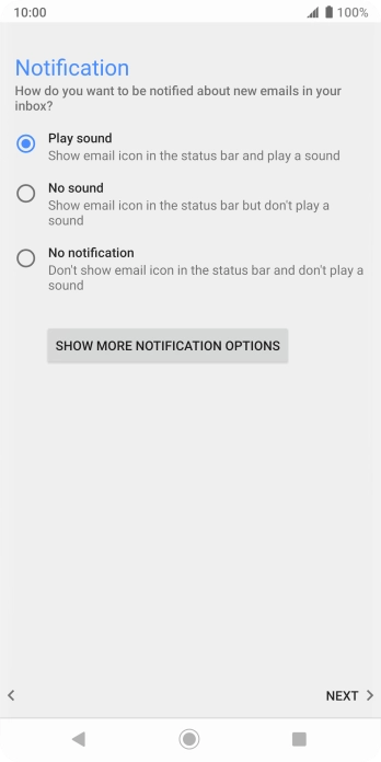

Press the drop down list below "Automatically".
Press the required setting.
Step 31 of 40
To turn on manual retrieval of email messages, press Manually.
Step 32 of 40
Press Sync email to turn on the function.
Step 33 of 40
Press NEXT.
Press NEXT.
