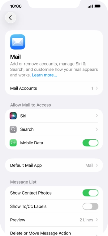

Press Apps.
Press Apps.
Step 2 of 48
Press Apps.
Press Mail.
Press Mail.

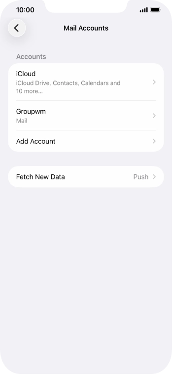

Press Mail Accounts.
Step 4 of 48
Press Add Account.
Press Add Account.

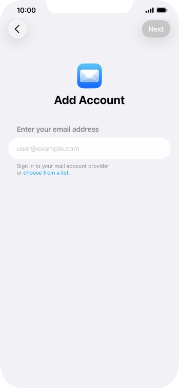

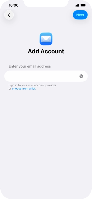

Step 5 of 48
Press Add Account.
Press the field below
Step 6 of 48
Press Next.
Press Next.
Step 7 of 48
Press Next.

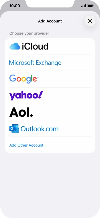

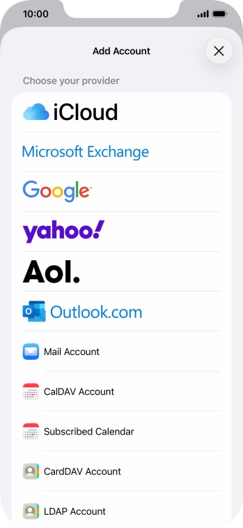

Press Add Other Account....
Step 8 of 48
Press Mail Account.
Press Mail Account.

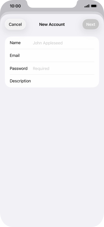

Step 9 of 48
Press Mail Account.

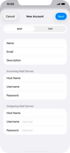

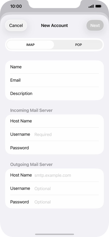

Press Name and key in the required sender name.
Step 10 of 48
Step 11 of 48
Press Description and key in the required name.
Step 12 of 48

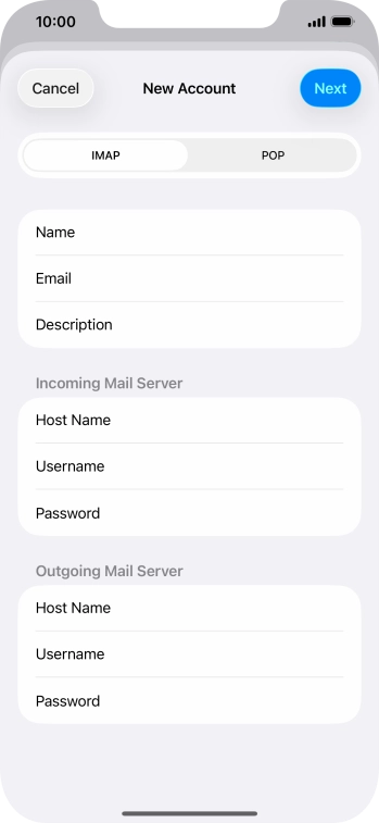

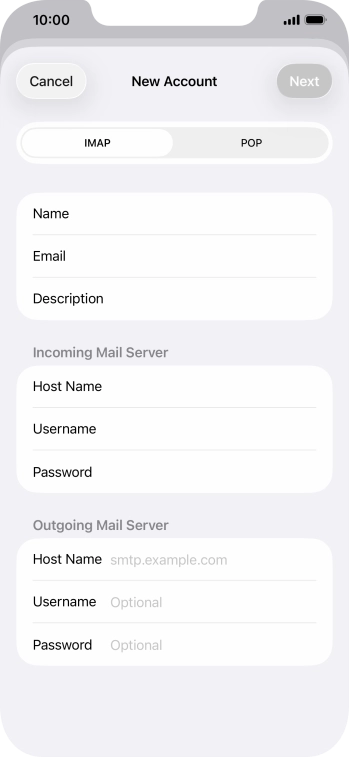

Press Next.
Press Next.
Step 13 of 48
Press Next.

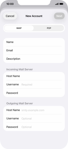

Step 14 of 48
Press IMAP.
Press IMAP.
Step 15 of 48
Press IMAP.

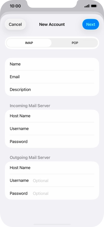

Press Host Name and key in the name of your email provider's incoming server.
Step 16 of 48
Press Username and key in the username for your email account.
Step 17 of 48
Press Host Name and key in the name of your email provider's outgoing server.
Step 18 of 48
Step 19 of 48

Press arrow left.
Press arrow left.
Step 23 of 48
Press arrow left.
Press the name of the email account you've just set up.

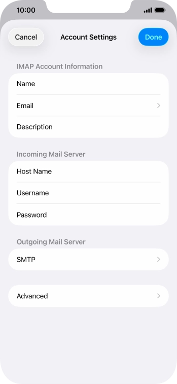

Press Account Settings.

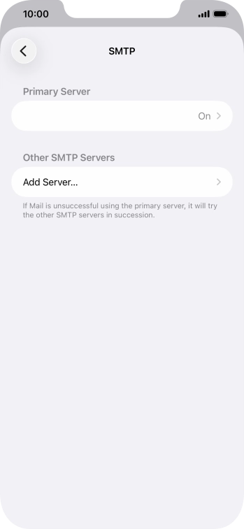

Step 25 of 48
Press SMTP.
Press SMTP.
Step 26 of 48
Press SMTP.

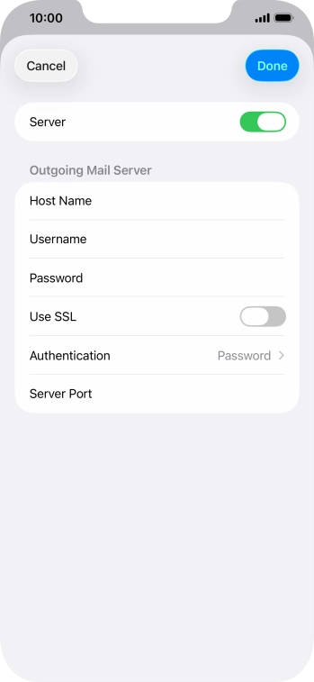

Step 27 of 48
Press the field below "Primary Server".
Step 28 of 48
Press the indicator next to "Use SSL" to turn on the function.

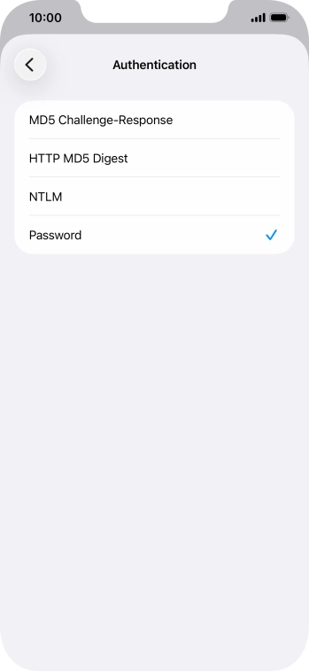

Press Authentication.
Step 29 of 48
Press Password.
Press Password.
Step 30 of 48
Press Password.
Press arrow left.
Press arrow left.
Step 31 of 48
Press arrow left.
Press Server Port and key in 587.
587
587
Step 32 of 48
Press Done.
Press Done.

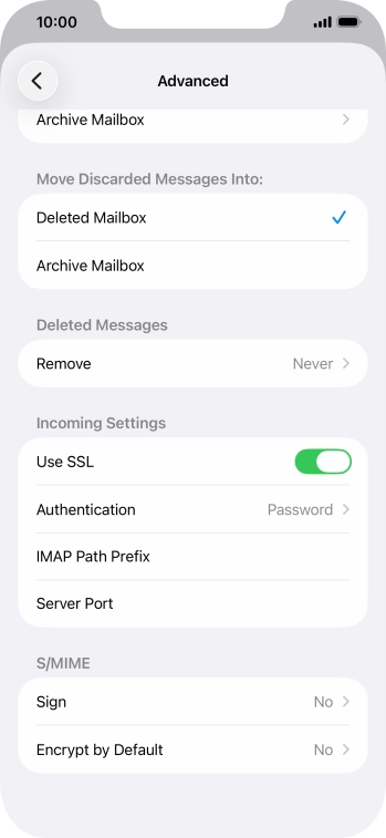

Press Advanced.
Press Advanced.
Step 35 of 48

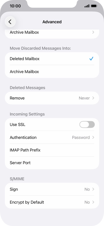

Press Advanced.
Step 36 of 48
Step 37 of 48
Press Password.
Press Password.
Step 38 of 48
Press Password.
Press arrow left.
Press arrow left.
Step 39 of 48
Press arrow left.
Press Server Port and key in 993.
993
993

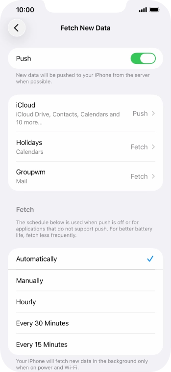

Step 43 of 48
Press arrow left.
Press Fetch New Data.
Step 44 of 48
Step 45 of 48
Press the indicator next to "Push" to turn the function on or off.
If you turn off the function, press the required setting.
Step 46 of 48
Press the required email account and follow the instructions on the screen to select settings for the specific account.
Step 47 of 48
