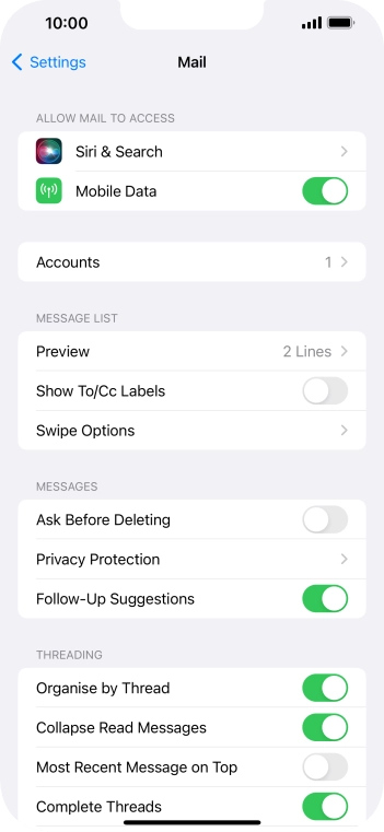

You can set up your phone to send and receive email messages from your email accounts. Using IMAP, your email messages are kept on the server and are synchronised between all of your devices. You're then able to access your email messages from other devices. To set up your phone for IMAP email, you need to set up your phone for internet.

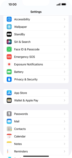

Step 1 of 45
Press Mail.
Press Mail.

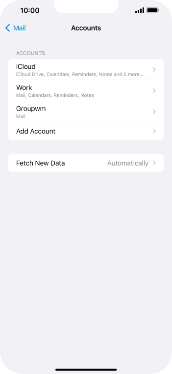

Step 2 of 45
Press Mail.

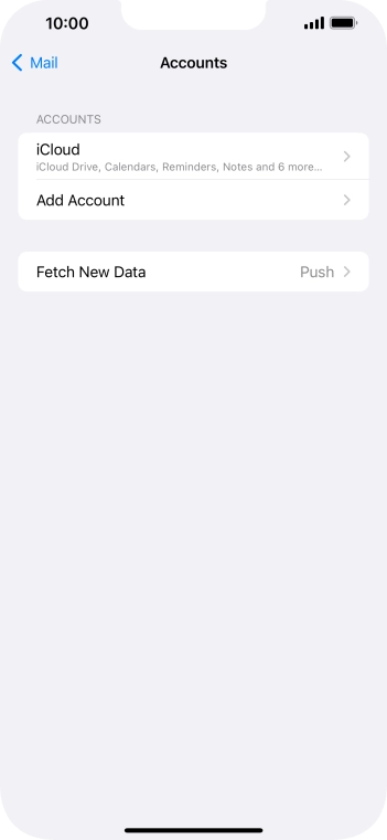

Press Accounts.
Press Accounts.

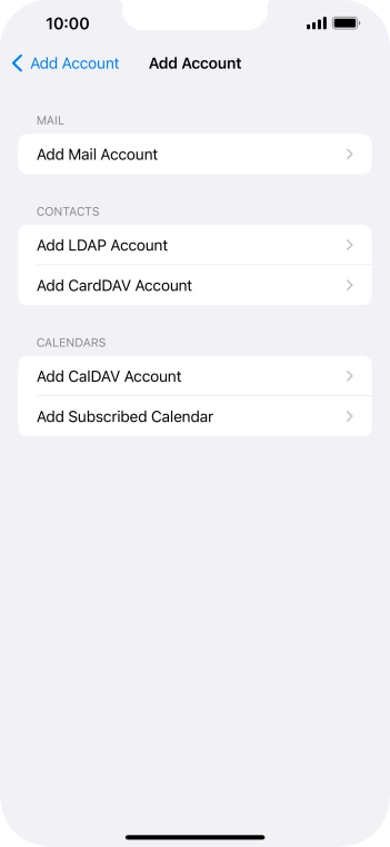

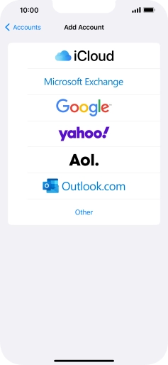

Step 3 of 45
Press Accounts.
Press Add Account.
Press Add Account.

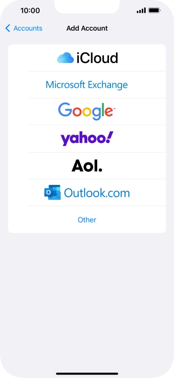

Step 4 of 45
Press Add Account.
Press Other.
Press Other.
Step 5 of 45
Press Other.
If the name of your email provider is on the list, press this instead.
Press Add Mail Account.

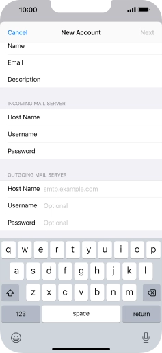

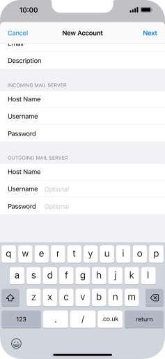

Step 6 of 45

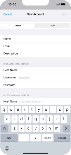

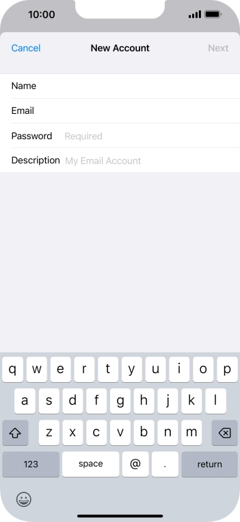

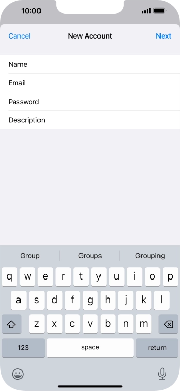

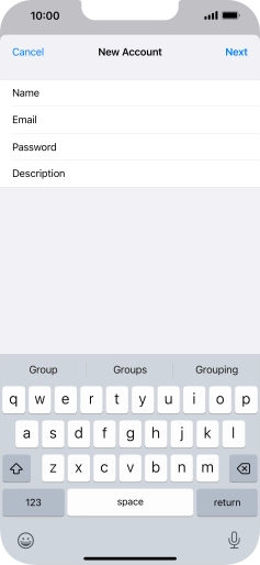

Press Name and key in the required sender name.
Step 7 of 45

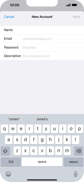

Press Email and key in your email address.
Step 8 of 45

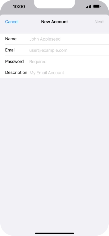

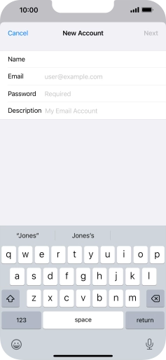

Step 9 of 45
Press Description and key in the required name.
Step 10 of 45
Press Next.
Press Next.
Step 11 of 45
Press Next.

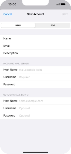

Step 12 of 45

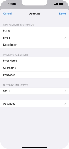

Press IMAP.
Press IMAP.
Step 13 of 45
Press IMAP.

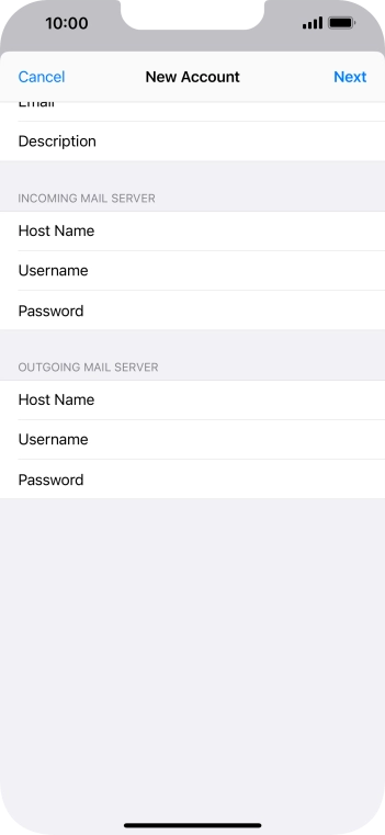

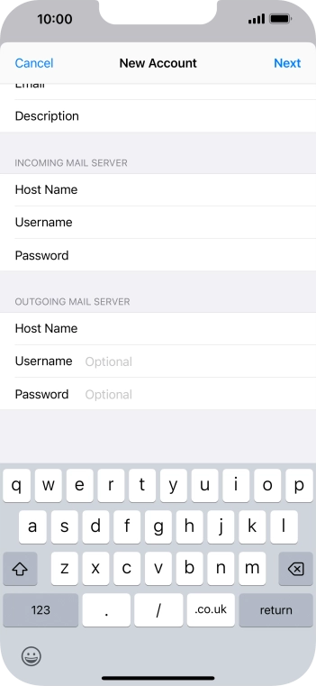

Press Host Name and key in the name of your email provider's incoming server.
Step 14 of 45
Press Username and key in the username for your email account.
Step 15 of 45

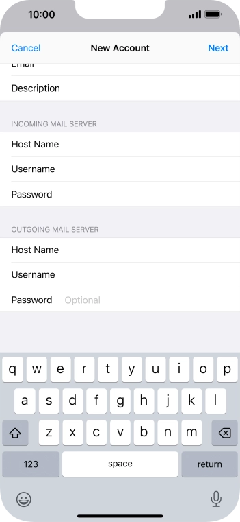

Press Host Name and key in the name of your email provider's outgoing server.
Step 16 of 45
Step 17 of 45
Step 18 of 45
Press Next.
Press Next.

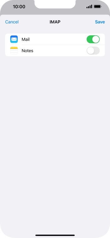

Step 19 of 45
Press Next.
Press Save. Your email account has now been set up. To select more settings for incoming and outgoing server, proceed with the following steps.

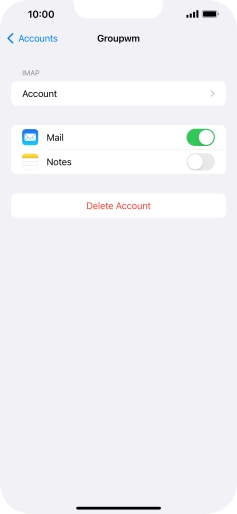

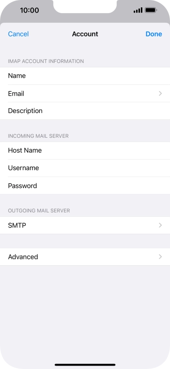

Press the name of the email account you've just set up.
Step 21 of 45
Press Account.
Press Account.
Step 22 of 45
Press Account.

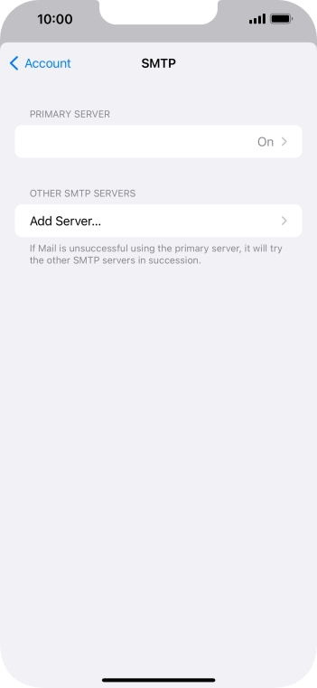

Press SMTP.
Press SMTP.
Step 23 of 45
Press SMTP.

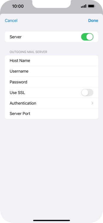

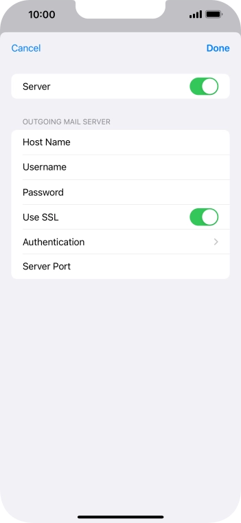

Press the field below
Step 24 of 45
Press the field below "PRIMARY SERVER".
Step 25 of 45

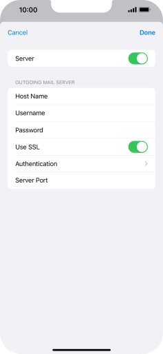

Press the indicator next to "Use SSL" to turn on the function.
It's recommended that you turn on encryption of outgoing email messages so that all email messages you send are encrypted and secured in the best possible way.

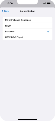

Press Authentication.
Step 26 of 45
Press Password.
Press Password.
Step 27 of 45
Press Password.
Press arrow left.
Press arrow left.
Step 28 of 45
Press arrow left.
Press Server Port and key in 587.
587
587
Step 29 of 45
If you're having problems sending email messages, try keying in 465 instead or ask your email provider for the correct outgoing port.
Press Done.
Press Done.

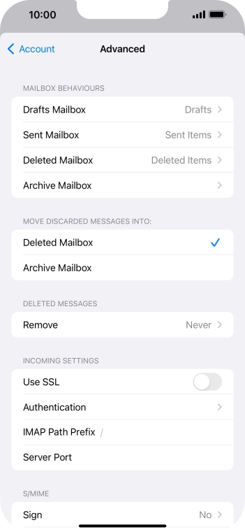

Step 32 of 45
Press Advanced.

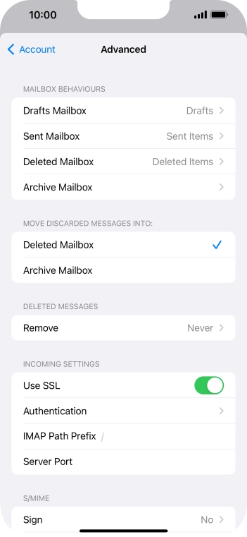

Step 33 of 45
It's recommended that you turn on encryption of incoming email messages so that all email messages you receive are encrypted and secured in the best possible way.

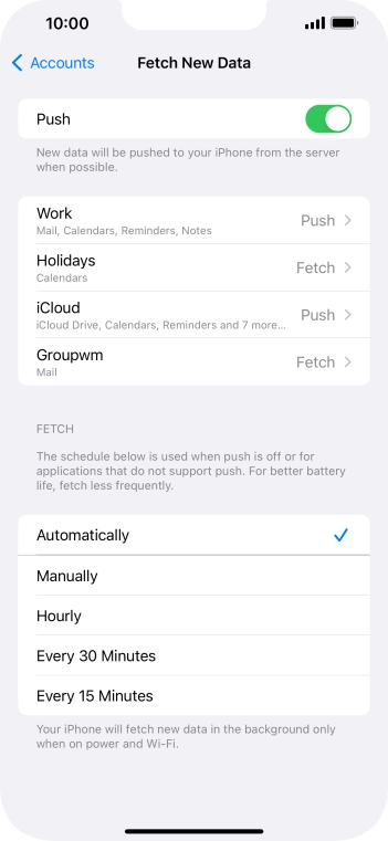

Step 40 of 45
Press arrow left.

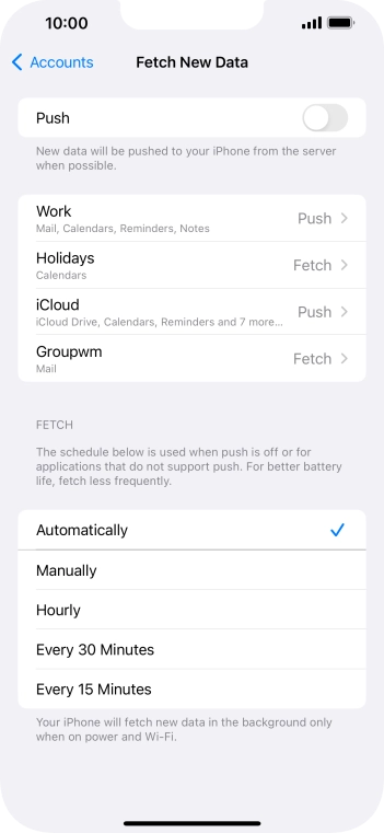

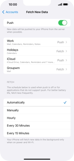

Press Fetch New Data.
Step 41 of 45
Step 42 of 45
Press the indicator next to "Push" to turn the function on or off.
If you turn off the function, press the required setting.
Step 43 of 45
Press the required email account and follow the instructions on the screen to select settings for the specific account.
Step 44 of 45
Step 45 of 45
