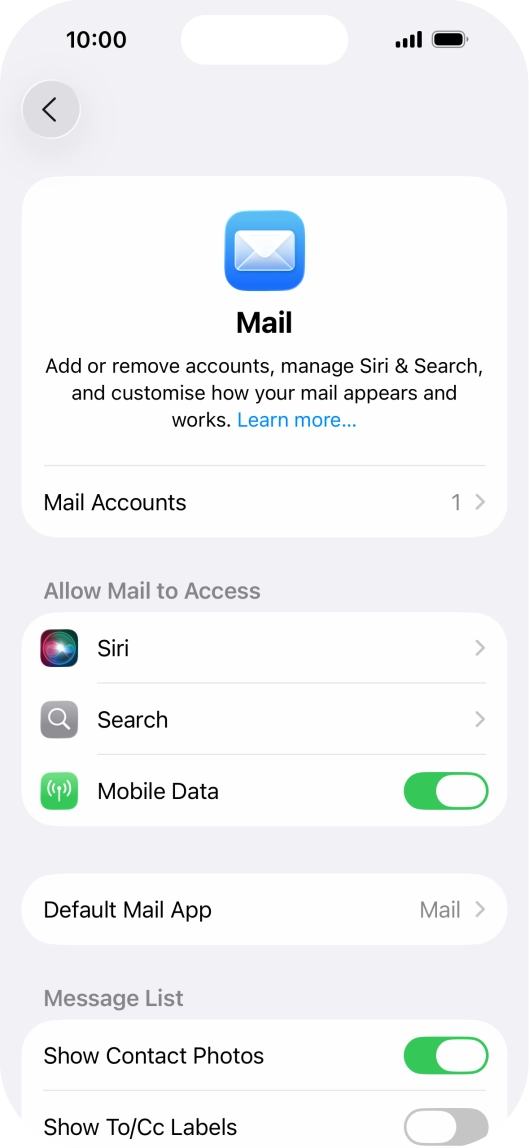

Press Apps.
Press Apps.
Step 2 of 48
Press Apps.
Press Mail.
Press Mail.
Step 3 of 48
Press Mail.
Press Mail Accounts.

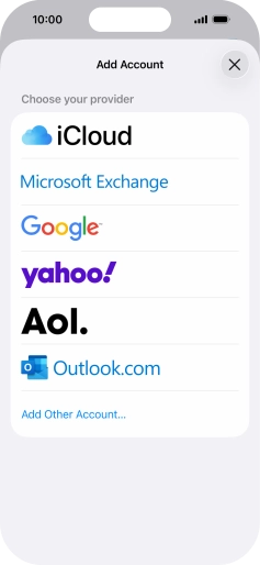

Step 7 of 48
Press Next.

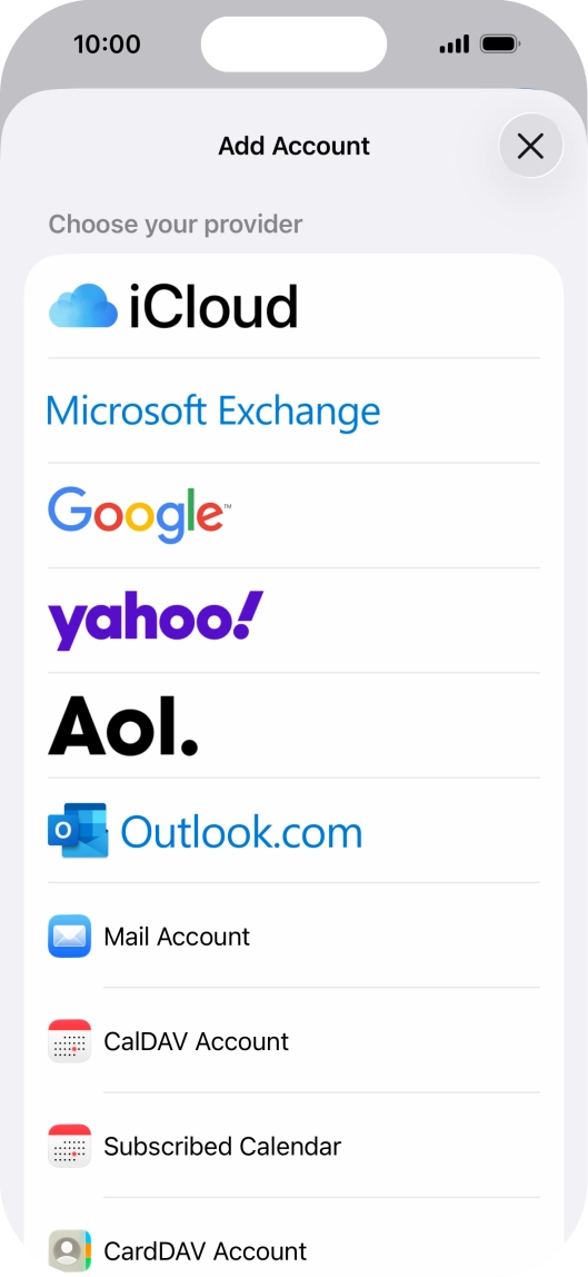

Press Add Other Account....
Step 8 of 48
If the name of your email provider is on the list, press this instead.
Press Mail Account.
Press Mail Account.

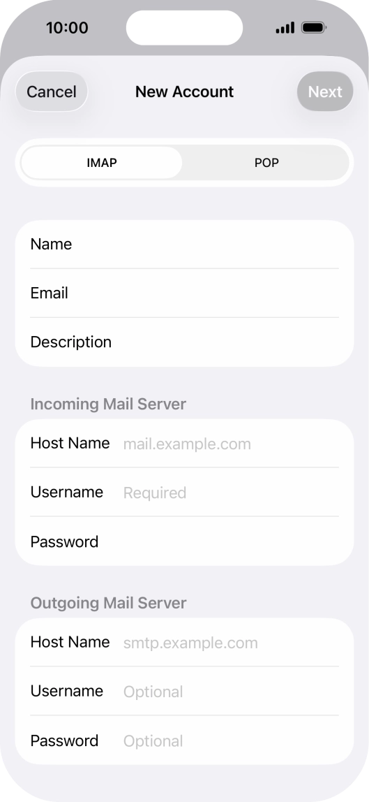

Step 13 of 48
Press Next.
Step 14 of 48
Press IMAP.
Press IMAP.
Step 15 of 48
Press IMAP.
Press Host Name and key in the name of your email provider's incoming server.
Step 16 of 48
Press Username and key in the username for your email account.
Step 17 of 48
Press Host Name and key in the name of your email provider's outgoing server.
Step 18 of 48
Step 19 of 48

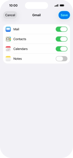

Step 21 of 48
Press Next.
Press Save. Your email account has now been set up. To select more settings for incoming and outgoing server, proceed with the following steps.
Step 22 of 48

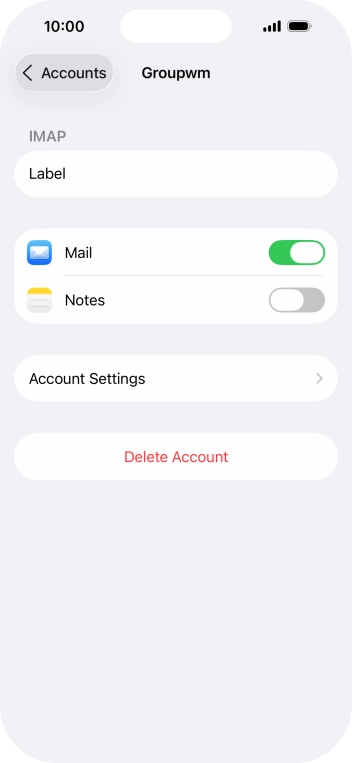

Press the name of the email account you've just set up.
Step 24 of 48
Press Account Settings.

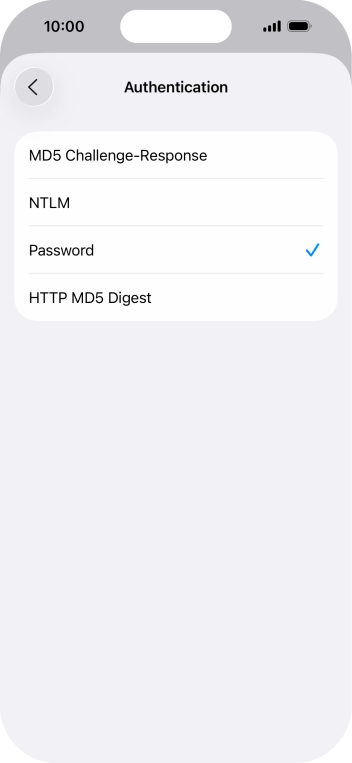

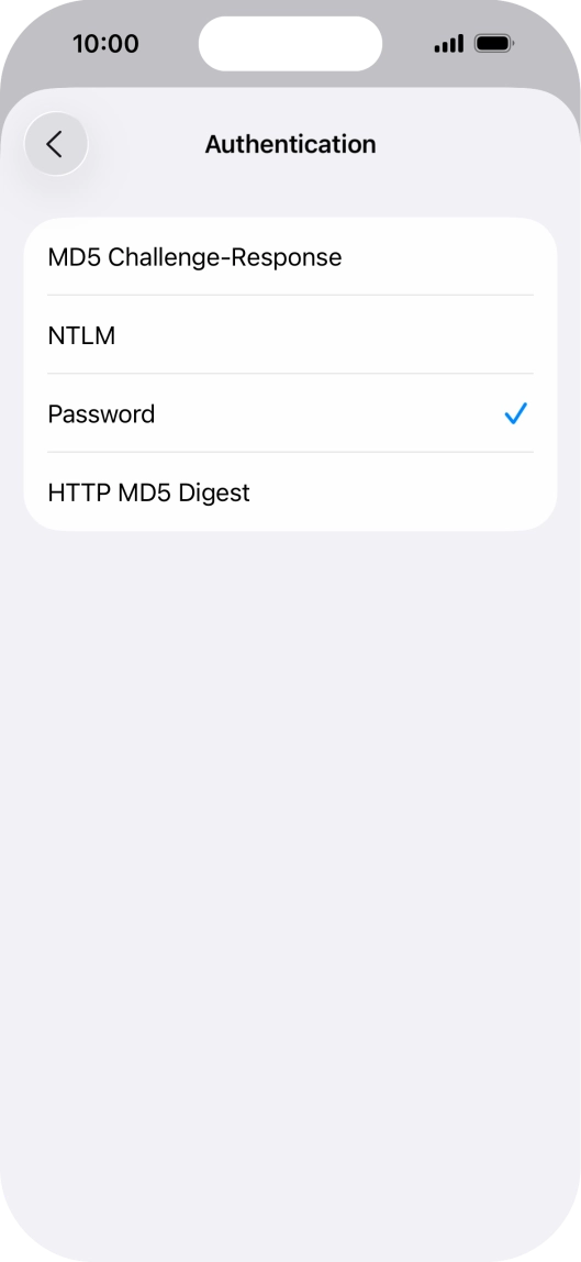

Press Authentication.
Step 29 of 48
Press Password.
Press Password.
Step 30 of 48
Press Password.
Step 37 of 48
Press Password.
Press Password.

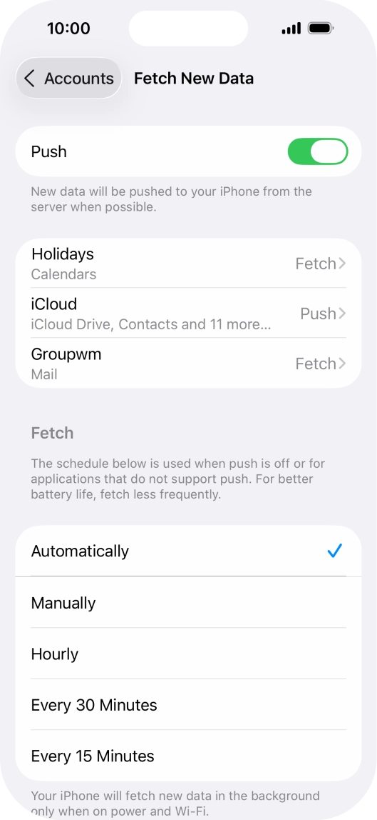

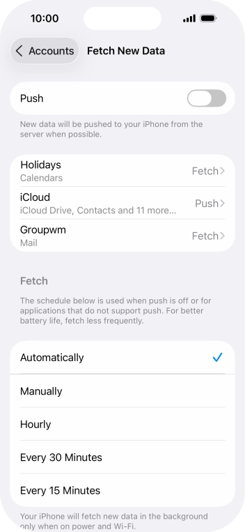

Step 45 of 48
Press the indicator next to "Push" to turn the function on or off.
If you turn off the function, press the required setting.
Step 46 of 48
Press the required email account and follow the instructions on the screen to select settings for the specific account.
Step 47 of 48
