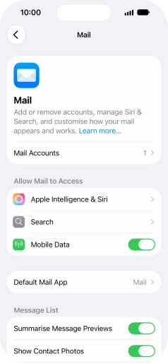

Step 1 of 47
Press Apps.
Press Apps.
Step 2 of 47
Press Apps.

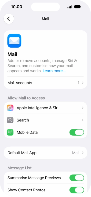

Press Mail.
Press Mail.

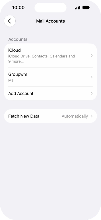

Step 3 of 47
Press Mail.

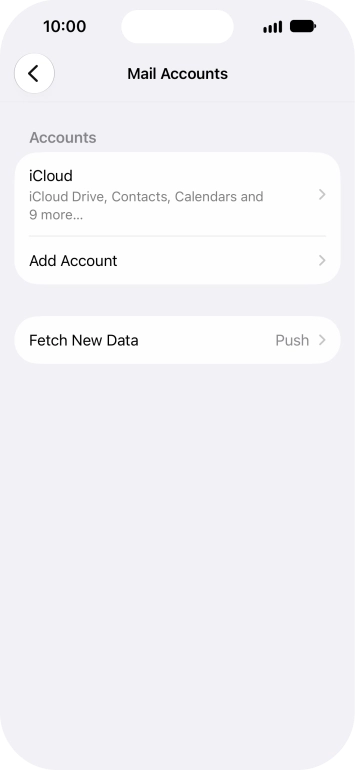

Press Mail Accounts.
Step 4 of 47
Press Add Account.
Press Add Account.

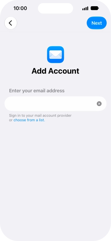

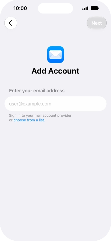

Step 5 of 47
Press Add Account.
Press the field below
Step 6 of 47
Press Next.
Press Next.

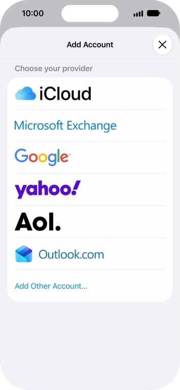

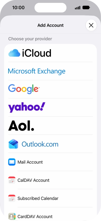

Step 7 of 47
Press Next.
Press Add Other Account....
Step 8 of 47
Press Mail Account.
Press Mail Account.

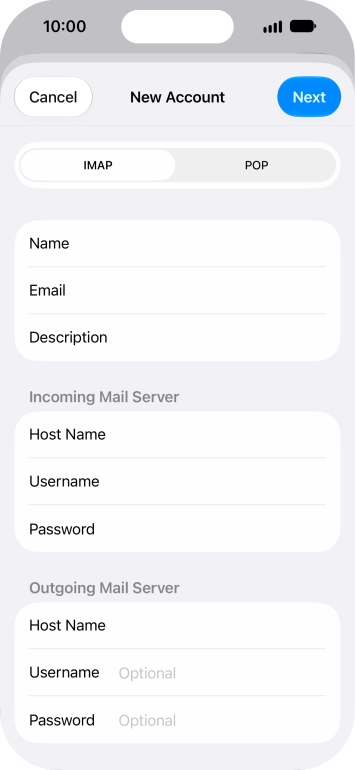

Step 9 of 47
Press Mail Account.

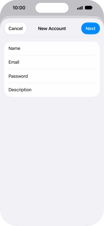

Press Name and key in the required sender name.
Step 10 of 47
Step 11 of 47
Press Description and key in the required name.
Step 12 of 47
Press Next.
Press Next.
Step 13 of 47
Press Next.

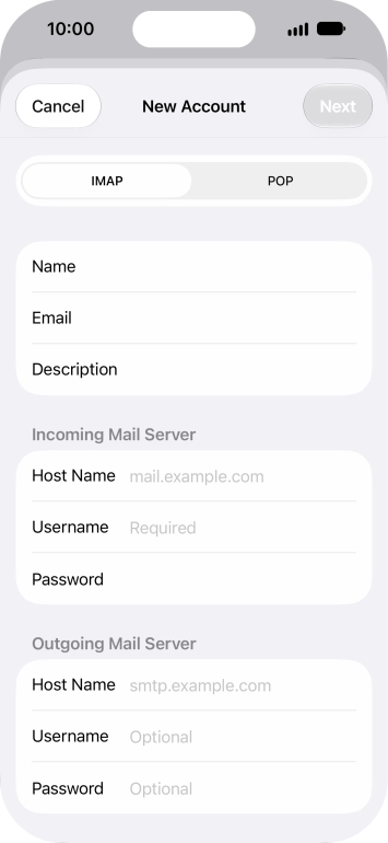

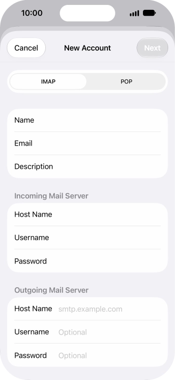

Step 14 of 47
Press IMAP.
Press IMAP.
Step 15 of 47
Press IMAP.
Press Host Name and key in the name of your email provider's incoming server.
Step 16 of 47
Press Username and key in the username for your email account.
Step 17 of 47
Press Host Name and key in the name of your email provider's outgoing server.
Step 18 of 47
Step 19 of 47
Step 20 of 47
Press Next.
Press Next.
Step 21 of 47
Press Next.

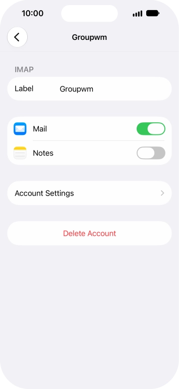

Press Save. Your email account has now been set up. To select more settings for incoming and outgoing server, proceed with the following steps.
Step 22 of 47
Press the name of the email account you've just set up.
Step 23 of 47
Press Account Settings.

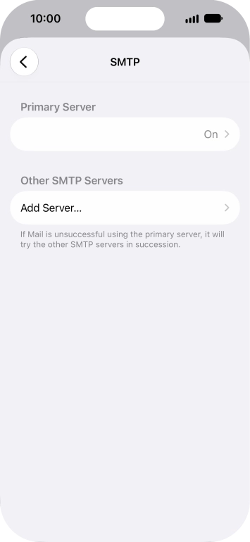

Press SMTP.
Press SMTP.

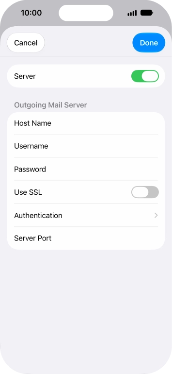

Step 25 of 47
Press SMTP.
Step 26 of 47
Press the field below "Primary Server".
Step 27 of 47

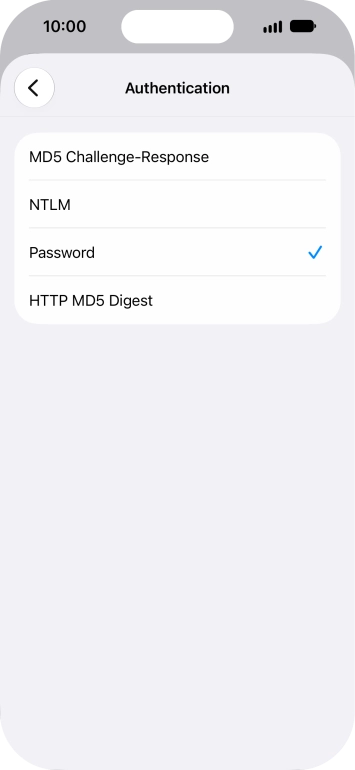

Press the indicator next to "Use SSL" to turn on the function.
Press Authentication.
Step 28 of 47
Press Password.
Press Password.
Step 29 of 47
Press Password.
Press arrow left.
Press arrow left.
Step 30 of 47
Press arrow left.
Press Server Port and key in 587.
587
587
Step 31 of 47
Press Done.
Press Done.
Step 32 of 47
Press Done.
Press arrow left.
Press arrow left.

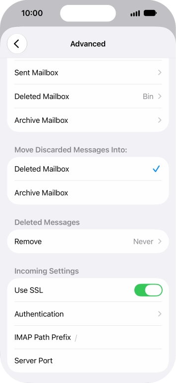

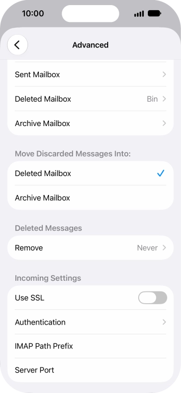

Press Advanced.
Press Advanced.
Step 34 of 47
Press Advanced.
Step 35 of 47
Step 36 of 47
Press Password.
Press Password.

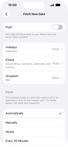

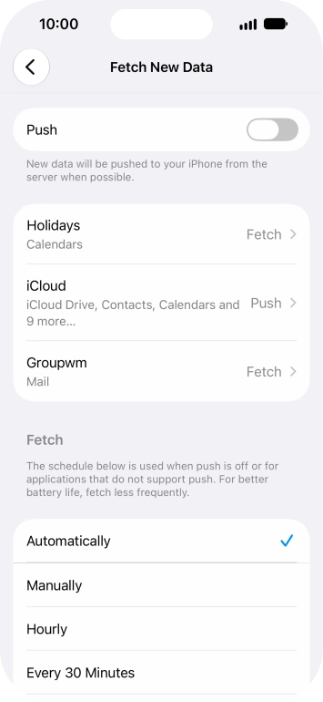

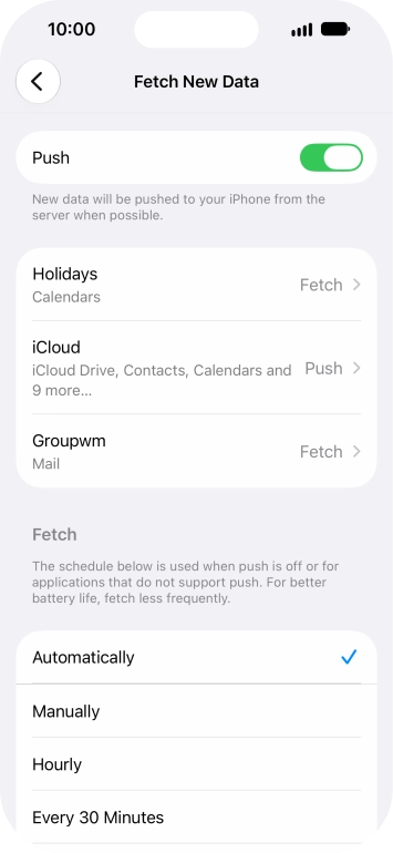

Press Fetch New Data.
Step 43 of 47
Step 44 of 47
Press the indicator next to "Push" to turn the function on or off.
If you turn off the function, press the required setting.
Step 45 of 47
Press the required email account and follow the instructions on the screen to select settings for the specific account.
