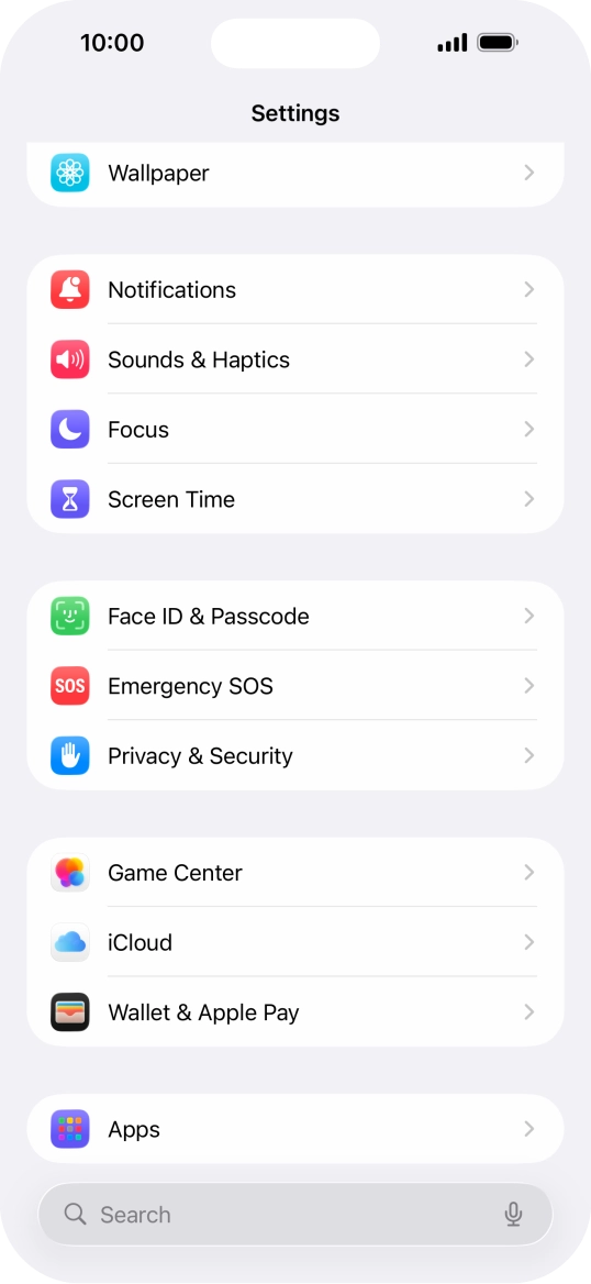

You can set up your phone to send and receive email messages from your email accounts. Using IMAP, your email messages are kept on the server and are synchronised between all of your devices. You're then able to access your email messages from other devices. To set up your phone for IMAP email, you need to set up your phone for internet.
Step 1 of 48

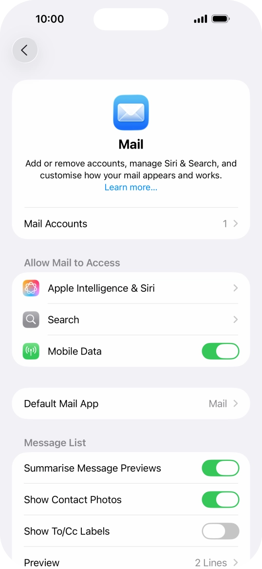

Press Apps.
Press Apps.
Step 2 of 48
Press Apps.
Press Mail.
Press Mail.
Step 3 of 48
Press Mail.

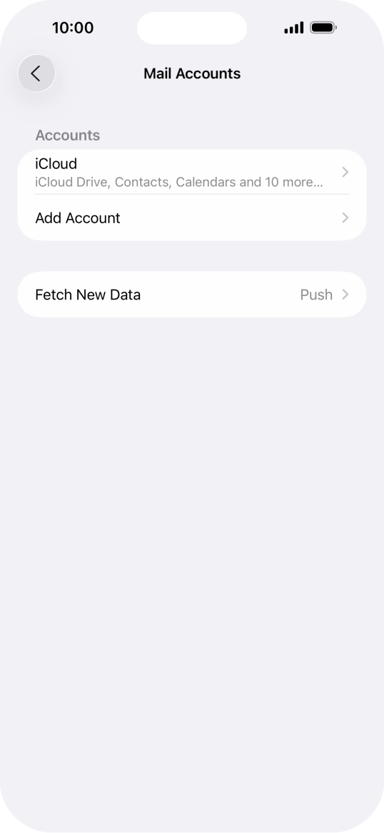

Press Mail Accounts.
Step 4 of 48
Press Add Account.
Press Add Account.

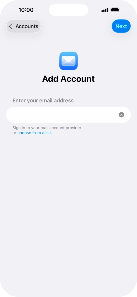

Step 5 of 48
Press Add Account.

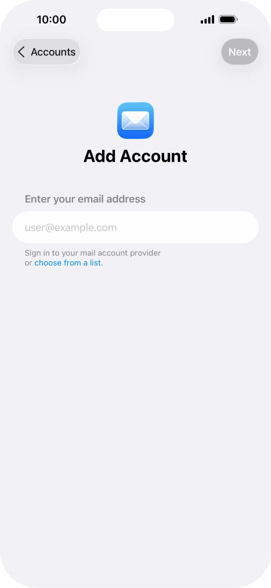

Press the field below
Step 6 of 48
Press Next.
Press Next.
Step 7 of 48
Press Next.

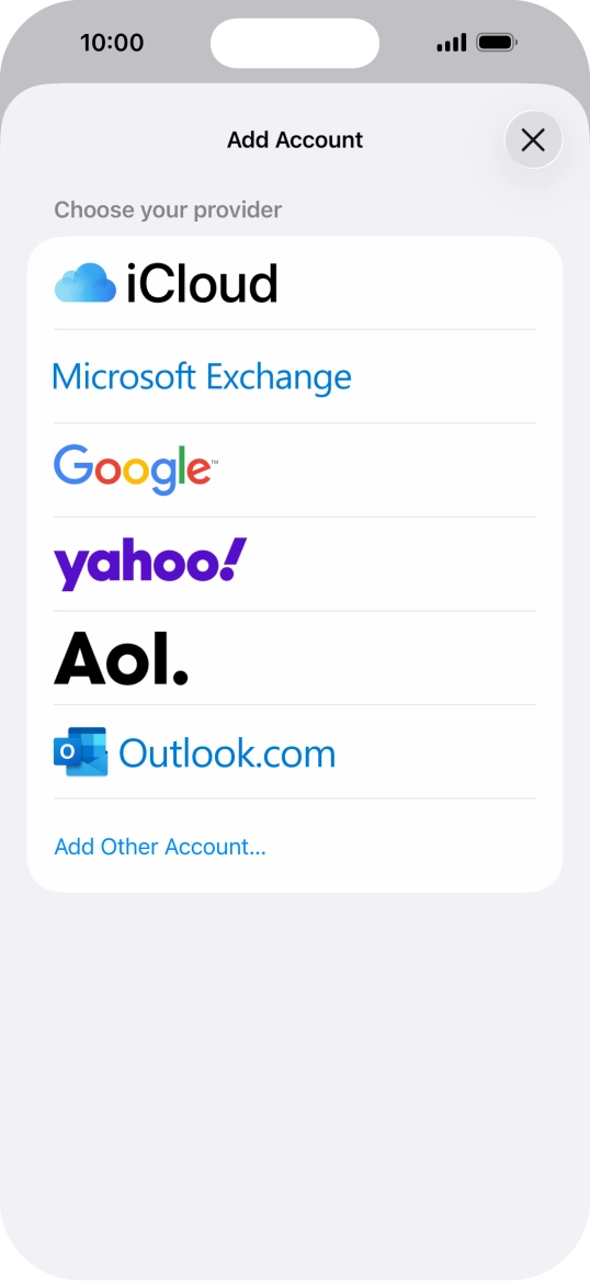

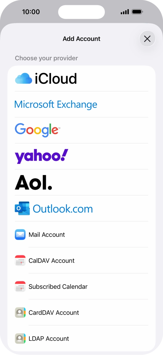

Press Add Other Account....
Step 8 of 48
If the name of your email provider is on the list, press this instead.
Press Mail Account.
Press Mail Account.
Step 9 of 48
Press Mail Account.

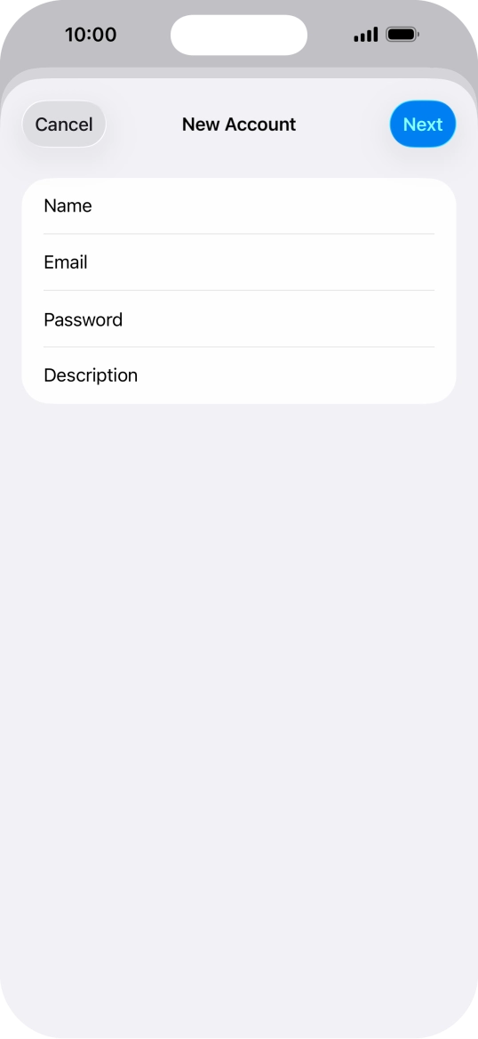

Press Name and key in the required sender name.
Step 10 of 48
Step 11 of 48
Press Description and key in the required name.
Step 12 of 48

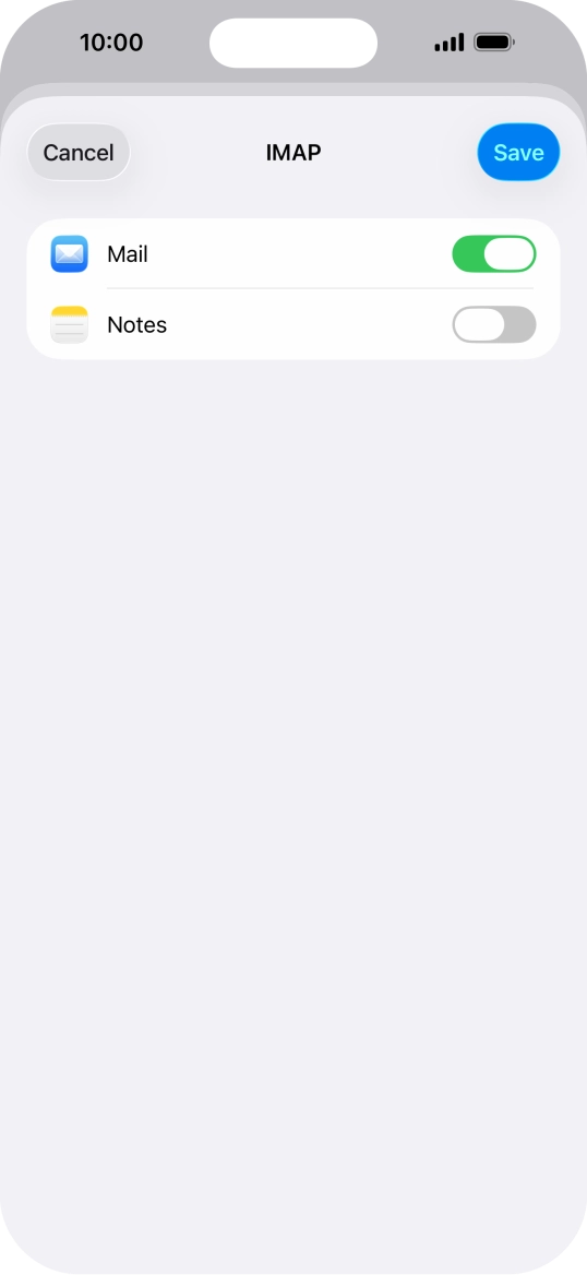

Step 20 of 48
Press Next.
Press Next.
Step 21 of 48
Press Next.
Press Save. Your email account has now been set up. To select more settings for incoming and outgoing server, proceed with the following steps.
Step 22 of 48

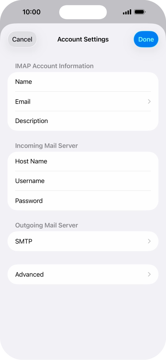

Press the name of the email account you've just set up.
Press Account Settings.
Step 25 of 48

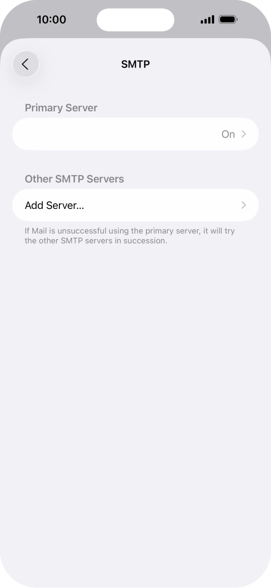

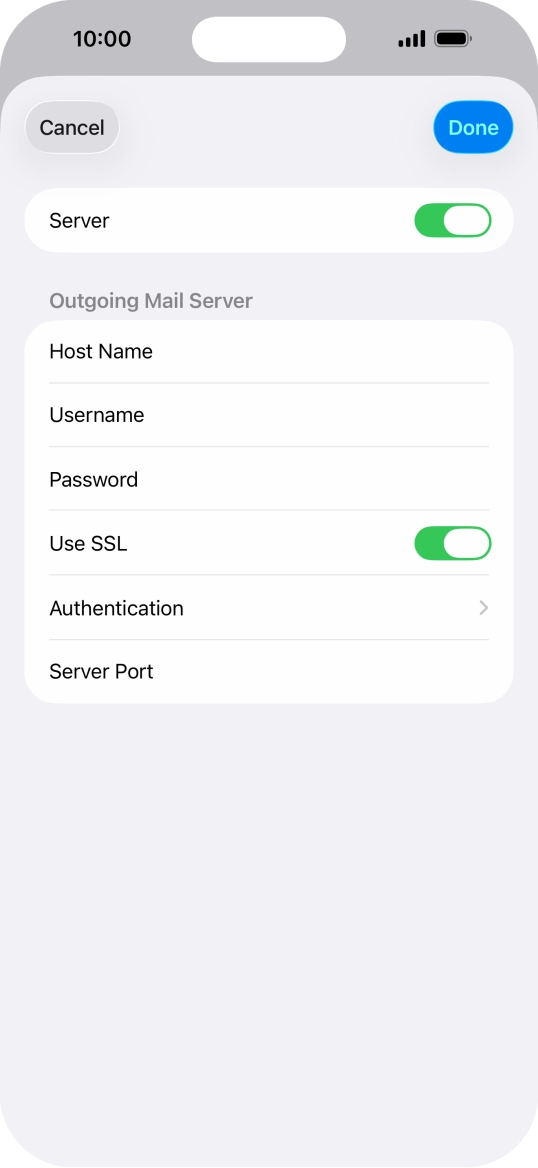

Press SMTP.
Press SMTP.
Step 26 of 48
Press SMTP.
Step 27 of 48
Press the field below "Primary Server".
Step 28 of 48

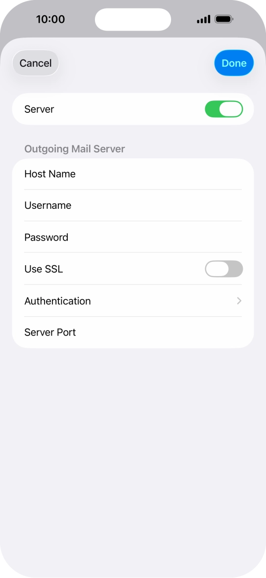

Press the indicator next to "Use SSL" to turn on the function.
It's recommended that you turn on encryption of outgoing email messages so that all email messages you send are encrypted and secured in the best possible way.

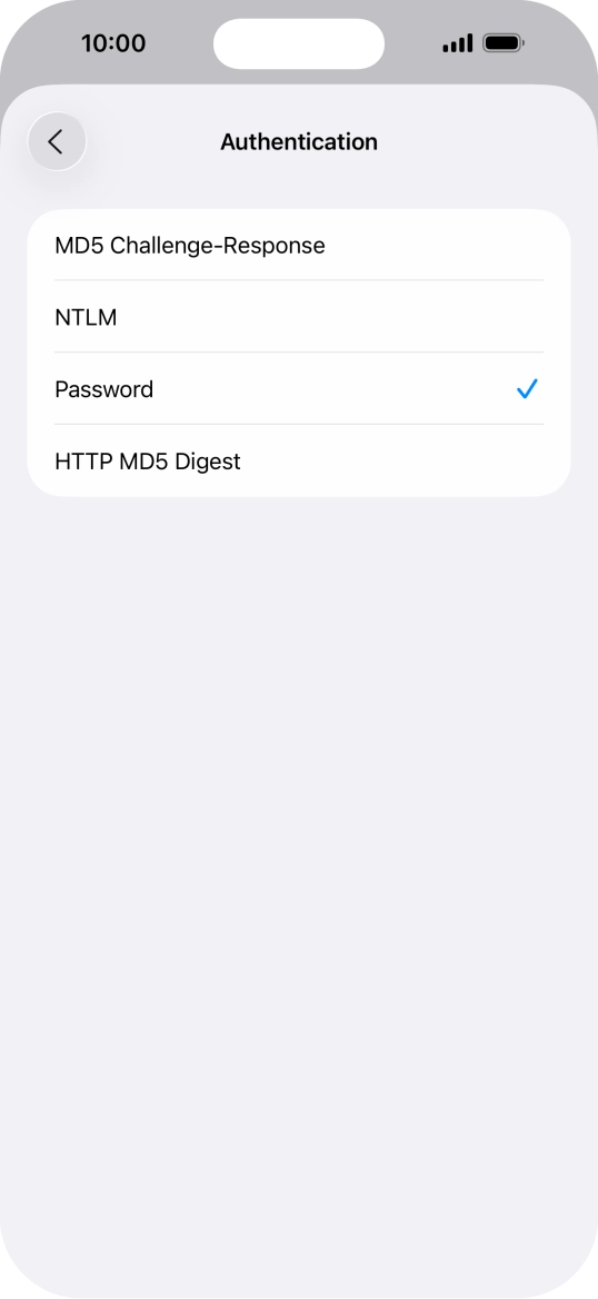

Press Authentication.
Step 29 of 48
Press Password.
Press Password.
Step 30 of 48
Press Password.
Press arrow left.
Press arrow left.
Step 31 of 48
Press arrow left.
Press Server Port and key in 587.
587
587
Step 32 of 48
If you're having problems sending email messages, try keying in 465 instead or ask your email provider for the correct outgoing port.
Press Done.
Press Done.
Step 33 of 48

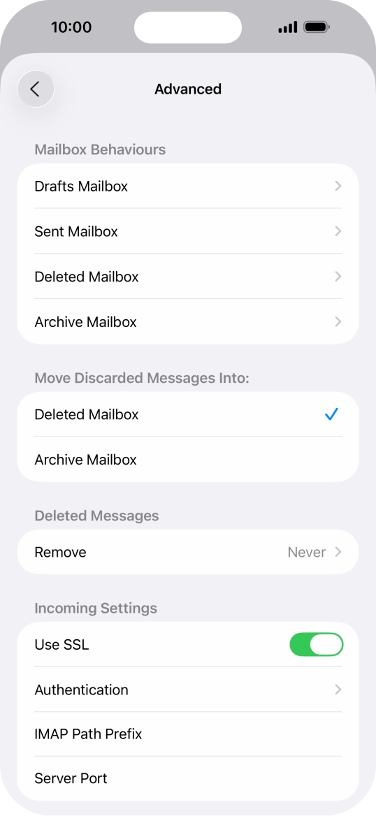

Press Advanced.
Press Advanced.
Step 35 of 48
Press Advanced.
Step 36 of 48

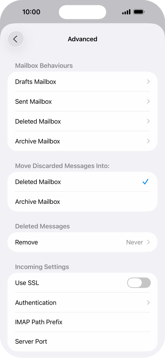

It's recommended that you turn on encryption of incoming email messages so that all email messages you receive are encrypted and secured in the best possible way.
Step 37 of 48
Press Password.
Press Password.
Step 38 of 48
Press Password.
Press arrow left.
Press arrow left.
Step 39 of 48
Press arrow left.
Press Server Port and key in 993.
993
993

Step 43 of 48
Press arrow left.

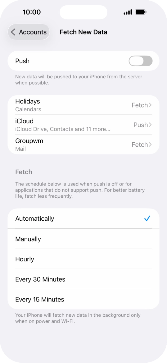

Press Fetch New Data.
Step 44 of 48
Step 45 of 48

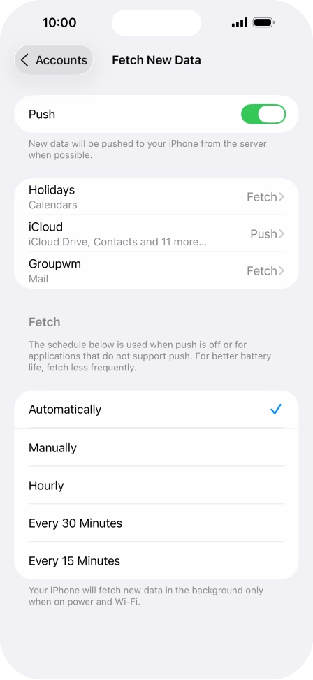

Press the indicator next to "Push" to turn the function on or off.
If you turn off the function, press the required setting.
Step 46 of 48
Press the required email account and follow the instructions on the screen to select settings for the specific account.
