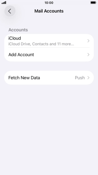

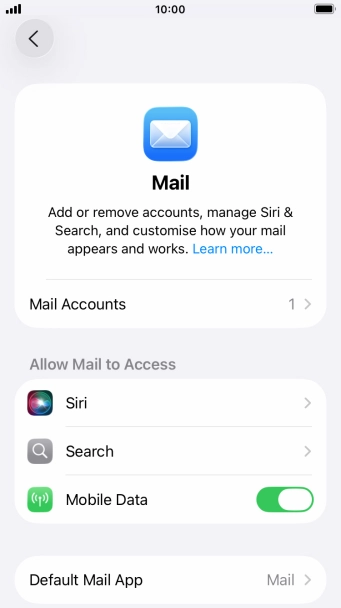

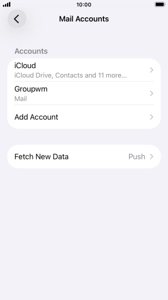

Step 3 of 48
Press Mail.
Press Mail Accounts.
Step 4 of 48

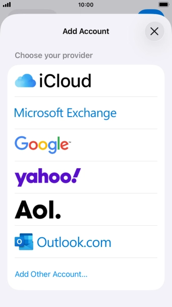

Press Add Account.
Press Add Account.

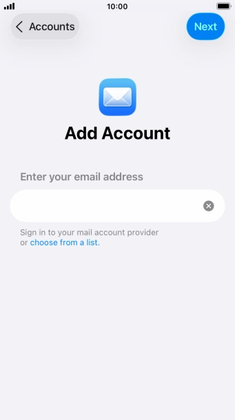

Step 5 of 48
Press Add Account.

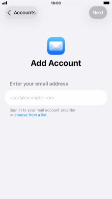

Press the field below

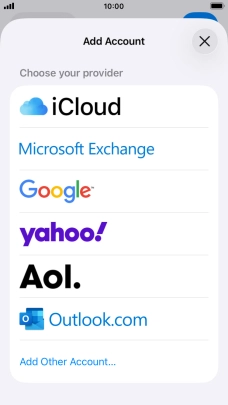

Step 6 of 48
Press Next.
Press Next.
Step 7 of 48
Press Next.

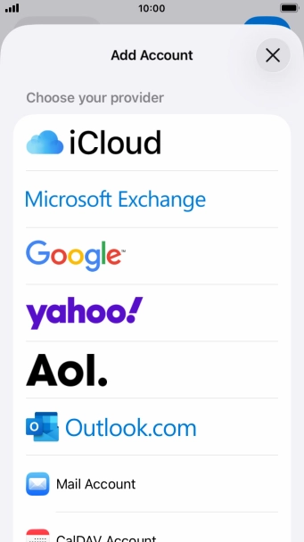

Press Add Other Account....
Step 8 of 48
Press Mail Account.
Press Mail Account.

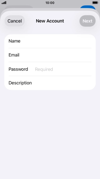

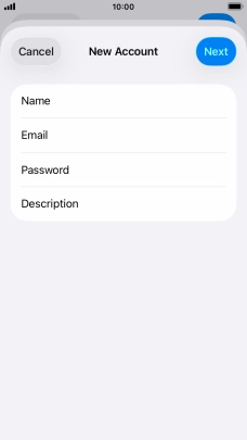

Step 9 of 48

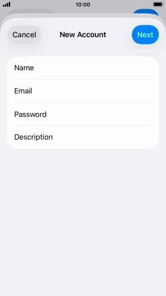

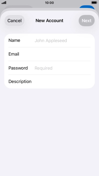

Press Mail Account.
Press Name and key in the required sender name.
Step 10 of 48
Step 11 of 48
Press Description and key in the required name.
Step 12 of 48
Press Next.
Press Next.

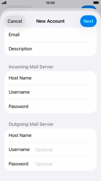

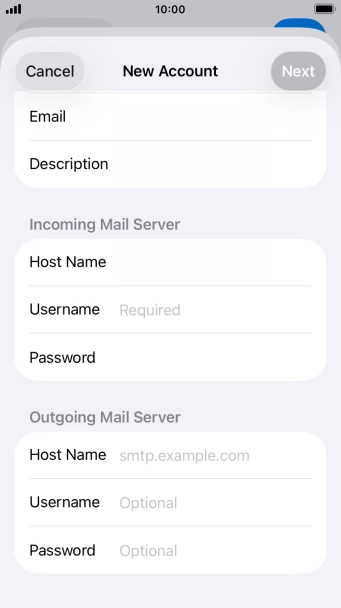

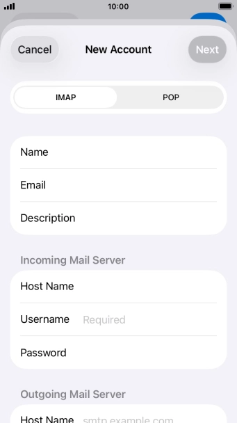

Step 14 of 48

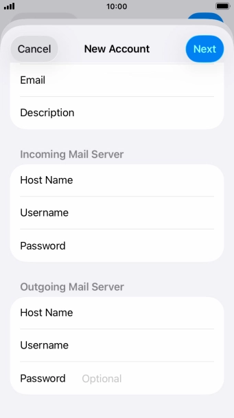

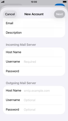

Press IMAP.
Press IMAP.
Step 15 of 48
Press IMAP.
Press Host Name and key in the name of your email provider's incoming server.
Step 16 of 48
Press Username and key in the username for your email account.
Step 17 of 48
Press Host Name and key in the name of your email provider's outgoing server.
Step 18 of 48
Step 19 of 48
Step 20 of 48
Press Next.
Press Next.

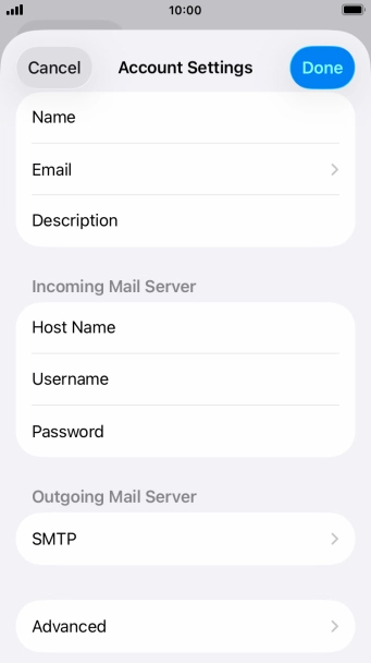

Step 21 of 48
Press Next.

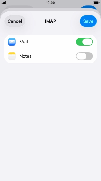

Press Save. Your email account has now been set up. To select more settings for incoming and outgoing server, proceed with the following steps.
Step 22 of 48
Press arrow left.
Press arrow left.

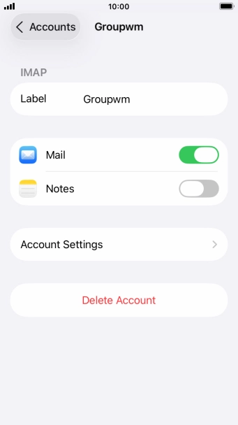

Step 23 of 48
Press arrow left.
Press the name of the email account you've just set up.
Step 24 of 48
Press Account Settings.
Step 25 of 48

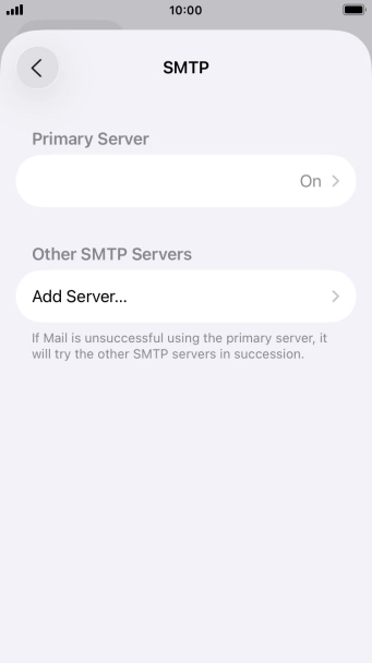

Press SMTP.
Press SMTP.

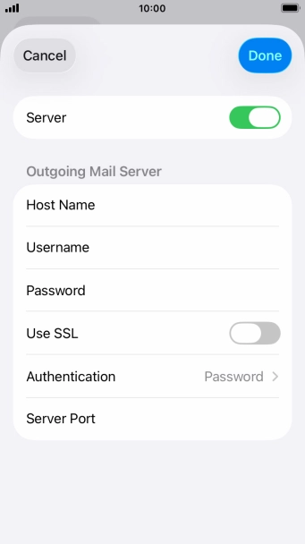

Step 26 of 48
Press SMTP.

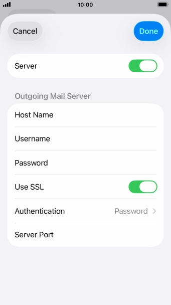

Step 27 of 48
Press the field below "Primary Server".
Step 28 of 48

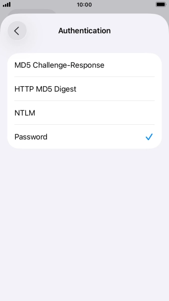

Press the indicator next to "Use SSL" to turn on the function.
Press Authentication.
Step 29 of 48
Press Password.
Press Password.

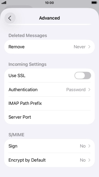

Step 34 of 48
Press arrow left.
Press Advanced.
Press Advanced.

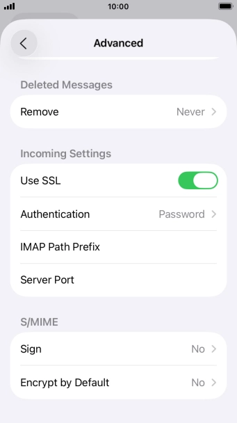

Step 35 of 48
Press Advanced.
Step 36 of 48
Step 37 of 48
Press Password.
Press Password.

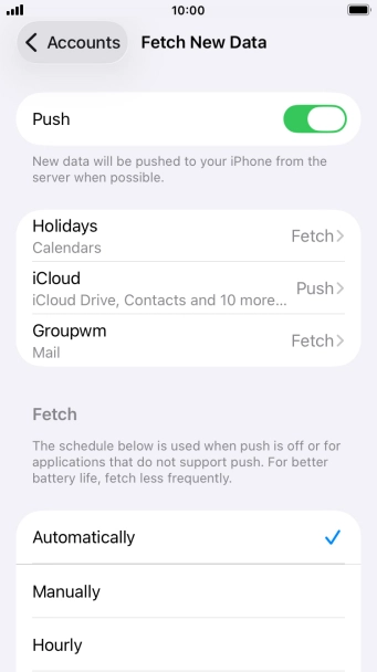

Step 43 of 48
Press arrow left.

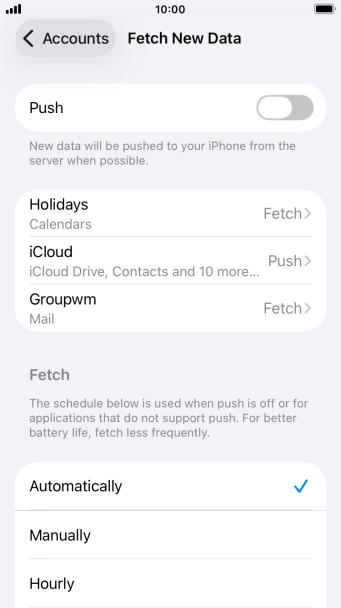

Press Fetch New Data.
Step 44 of 48
Step 45 of 48
Press the indicator next to "Push" to turn the function on or off.
If you turn off the function, press the required setting.
Step 46 of 48
Press the required email account and follow the instructions on the screen to select settings for the specific account.
